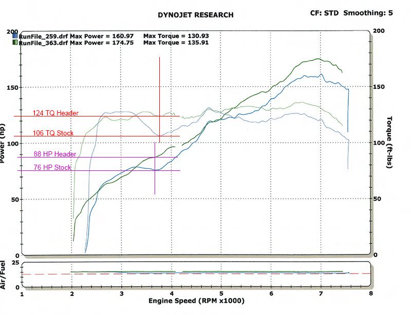

Just to supplement what TCoat noted, I personally felt a difference specifically around the torque dip. As TCoat mentioned, you can probably get just as much or more of a benefit from tuning the car. I however did not go that route as I didn’t want to be kicking myself in the rare off chance something would go wrong and the dealership won’t cover it because of my tune. For the OP, a tune would likely do more, I just wanted to say Howe much I like the header. Nothing drastic but it did make a correction. I haven’t nor intend to dyno my car but below is Ann image from their sight of the impact of the header without a tune.
https://images.jbautosports.com/imag...a7uchk05exssug

The manufacturers tune is limited by emissions and mileage constraints that don't take full advantage of even the stock components.
I got the impression that the stock cats are the main thing that aftermarket headers "solve". People got similar performance gains (torque dip flattening, etc.) with breaking the cats in the stock header. Plus the 2017+ headers are improved over 2016- in that regard (was a thread a while back with the conclusion that aftermarket headers don't contribute as much for 2017+ Twins).
Well since the sum of the total changes in 17 came to 5HP it is debatable that the header alone is much of an improvement.
Getting rid of the cats is probably not even giving a measurable improvement within the margin of error of a Dyno. It all goes back to the tune not the system itself. All in all we are probably looking at single digit numbers when talking headers in these cars not the huge increases you see by replacing a collector manifold.
No doubt people's butt dynos will argue that but they are usually calibrated by the Confirmation Bias Metering and Measurement Company.
