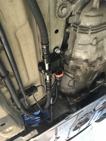

Old 08-16-2015, 04:47 PM   #24
johmei
Join Date: Aug 2015
Drives: BMW
Location: Sweden
Posts: 2
Lines and sensor fitted! Look forward to your analyzer action!
http://rejsa.nu/im/user/22856/2015-0...6_16.31.35.jpg
