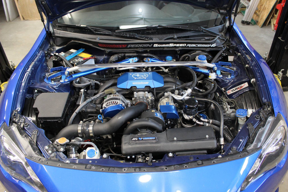

What's going on here??? There are some very striking yellow bits that must turn blue....
lol what? The battery will be gone and the only part left yellow is the sticker on top of the radiator fill tube
What will really throw you off is the red Cam Sensor Covers, Alternator and water pump pulleys.
