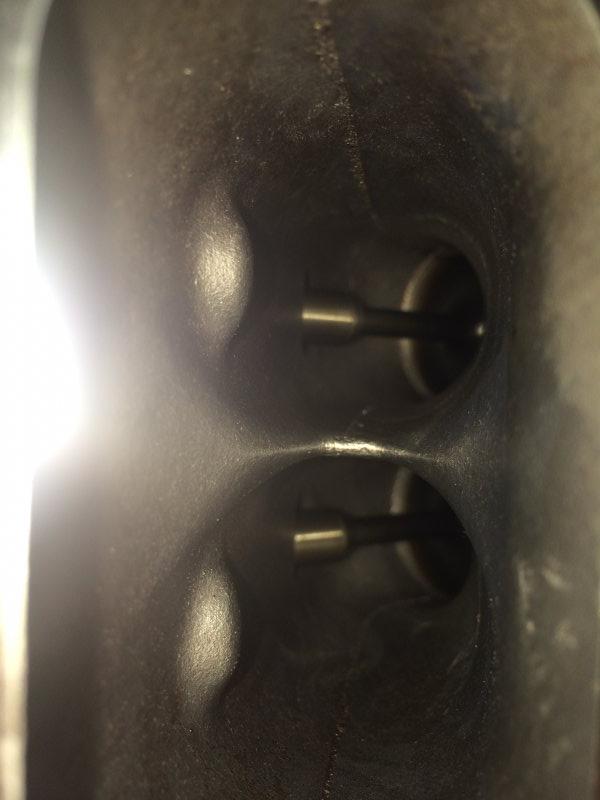

This is my motor, after 2 full race seasons on E85.
Here in Sweden we have some problems with the pink color detergent that the government ad too the E85, and often cases like a red go on the valves and ports (al most like carbon buildup) but that is cured with a little dash of Redline SI Alcohol cleaner/lubricant in every fill up.
