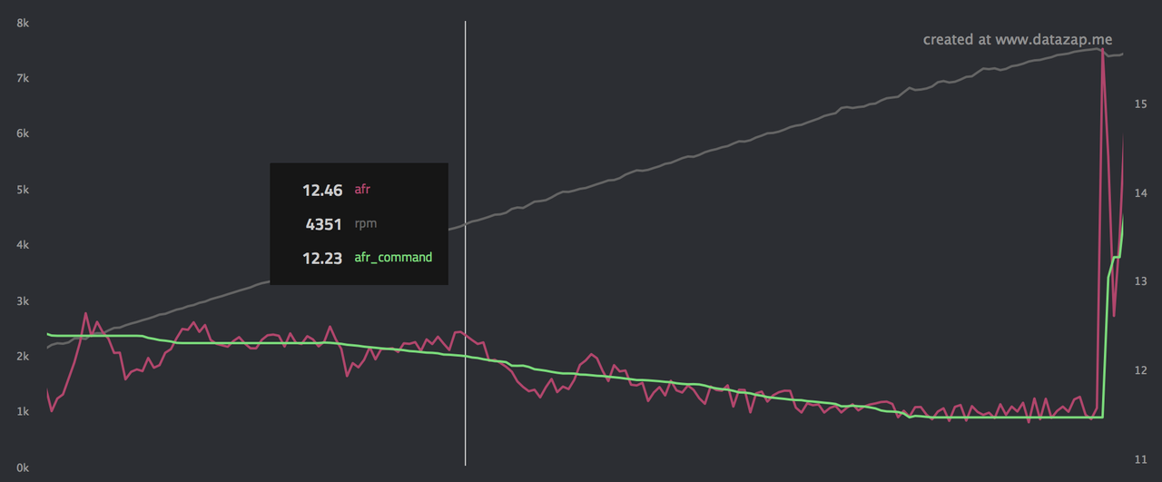

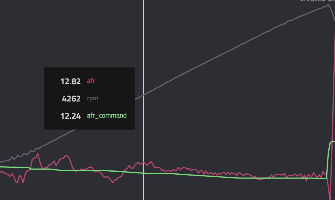

Originally Posted by Tor View Post
What makes this difficult is that you are not very specific about where you see which values. Again, a log of a WOT pull is worth more than a thousand words.
When you say:
You mean like this (as a pattern, here the extremes are not really too bad because I start with a MAF scale that I know will roughly fit):
No, but you can adjust load without affecting MAF.
Assuming that your problem is just a bumpy AFR curve like above and that you don't actually see 13.8 or 12.9 ALL throughout the pull (if that's the case you have a hardware issue)....
Then the way to do it is:
1) You need a well scaled MAF first. The MAF should not be used to clear the bumps in the WOT AFR curve. It should average them out while the MAF remains a smooth exponential curve.
2) Clear out the bumps in the AFR curve using engine load compensation.
Engine Load Compensation should NOT be used as a means to skip step 1 and make a properly scaled MAF, to begin with.
If the above scenario is your case... Take a few steps back, restore everything regarding the injector back to stock. Use an unmolested MAF scale, like from the OFT tunes. (A bumpy MAF is only harder to make smooth again and, hence, a bad starting point).
Make a full MAF scaling and do not apply any open loop corrections below 3 volts. Make sure that the MAF curve remains smooth and averages out bumps. Do not make bumps in the curve between 2 and 3 volts especially as this will mess up your fuel trims. While doing this try to keep the curve within +/-2% fuel error in CL. Do not make a bump in the transition between <3 volt and >3 volts. In fact, do not make any bump in the curve at all. (Did I say no bumps!).
After that make logs again and this time apply the corrections to the engine load compensation table. Closed loop corrections below 0.8 manifold pressure. And OL corrections above 0.8.
Same car as the screenshot above after MAF scaling and 1 adjustment to ELC (can still be improved a bit):
The problem with all the above is that it takes experience (or a lot of trial and error). The UEL headers of the JDL, Tomei or Gruppe-S design are a bit tricky to tune. They make weird stuff happen to the AFR in the midrange that you need to know how to compensate for.
i honestly wish i could get my wot log as good as the first graph it look way nicer than my datalog, i have added 15% more fuel on transient and as i step on throttle i get 13.8 then 11.98 then 13.6 then 11.2 then 12.1 then 12.8 so its random the swing is larger than 4% and i cant get it close enough to ignore it

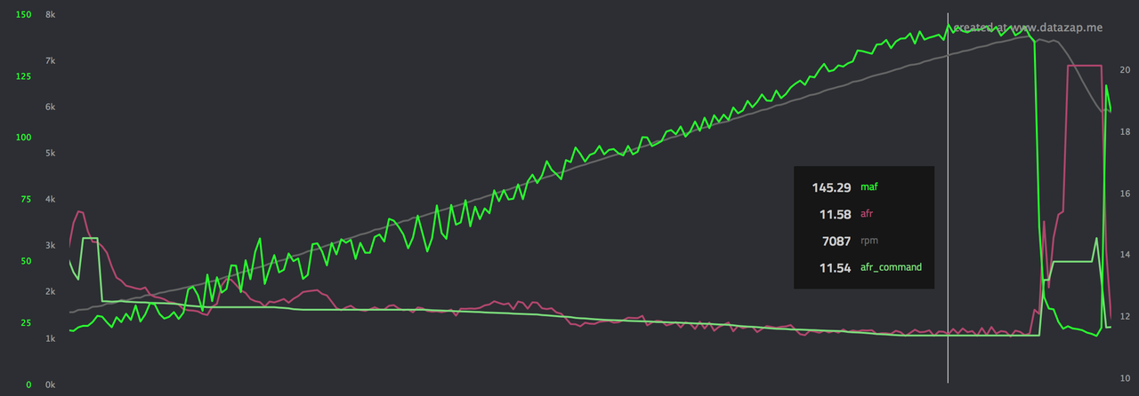

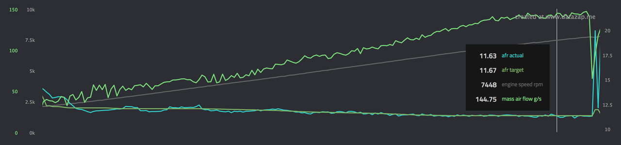

It shouldn't be necessary to make all these changes to a near stock car. If it's too lean on getting on the throttle at low rpm, it's more likely that the load limits are wrong.
The MAF values at high rpm in the delicious log are too low with 120 g/s. Whether, it's a sensor issue or a tune issue.
Same car as in the other screenshots (running Gruppe-S header):
Another car with Gruppe-S header (my own):
Tor is offline   Reply With Quote
