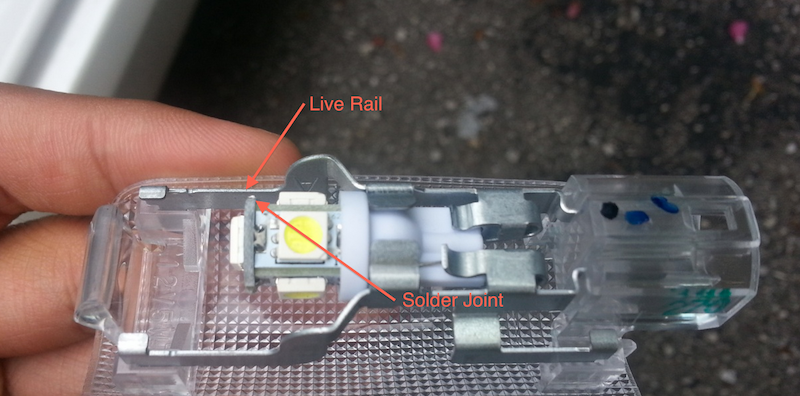

Checking out thread, I noticed that the LED bulb has a solder joint that sits just next to the metal frame, the frame carries the power.
This may be why some get the dreaded dead controller issue.
This metal frame should be insulated with black tape before inserting the Led.
Does anyone have one of the LED's to verify potential for short?
Here is the solder joint (taken from joergasm)
