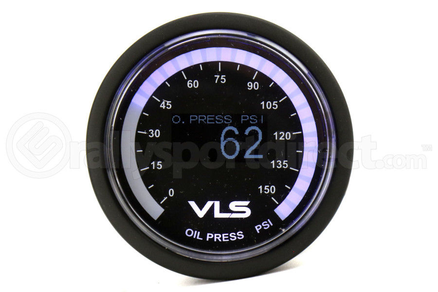

Edit: The Oil Pressure issue has been driving me nuts. I was going to just wait to grab the AIM early Next year, but I am not sure I can wait that long. Went ahead and grabbed a set of the VLS Oil Pressure and Oil Temp Gauges. Always getting asked for rides, which I am more than willing to fulfill. Last night after one lap of the ride. Idle Oil Pressure was showing about 12-15 PSI. WOT pulls oil pressure gauge wouldn't move until pull was over. So I HIGHLY suspect oil pressure gauge is dead. Either sensor is broken, or gauge itself. That or engine is holding together extremely well and is about to blow up haha. Should be here early next week.

That sucks on oil presure, you absolutely sure you got a good oil pump?....as far as exhaust gaskets....have you thought of putting two gaskets on instead of one in case the reason you are blowing them is they are not fitting perfectly flat against the mating surface?.....as a reference my oil pressure in Texas heat 90+ to 100 degree with a mocal oil cooler never goes below 20 psi at idle and fully heated is at 40 psi plus at 2k cruise....start up its at 60 cold then comes down....moble 1 5w30.
