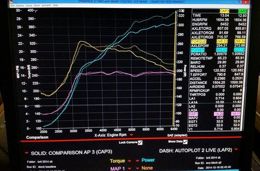

The gains on a stock STI are better than expected

Who would have thought this would be so amazing. I look forward to actual evidence.

Craford ecublock is basicly a spacer on the maf sensor.
What is does is move the position of the maf sensor so the sensor derects slightly less air flow.
What this will do is alter the ecu load calculation downwards
Lets assume 10% and im just plucking that figure out of the air.
So all the ecu calculations will be skewed for timing and fueling and even valve timing.
In closed loop ie cruise and light throttle the ecu will learn arround any fueling offset. You will just end up will different fuel trims .
But the ignition timing will end up being slighly higher in most cases as the ecu load calc will be shifted down 10% and that usually means more timing say 2 or 3 degrees.
It will also skew the valve timing this may be good or bad.
In open loop as the detected mass air flow is less and the load calculation lower will generally result in a leaner afr being targeted and less fuel injected ie its going to run leaner by say 10 %
In open loop which is full throttle or hard acceleration..
It will aslo run more ignition advance due the skewed load calculation.
On the stock tune if you have good fuel it possible this contraption will make some power as stock tunes in general run pretty rich for safety and cat converter temp control.
The srock tune on these cars is pretty agressive timing wise so its possible the leaning and additional timing will just result in knock and the ecu retarding timing to save motor.
These adjustments are very crude and not something i would do to my car. But in theory on stock tune with very good fuel it could work.
On a tuned car its likely to cause lots of problems
