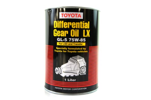

https://torsen.com/faq/
Torsen Type-1 differentials require lubricant with a GL-5 rating. Type-2 and T-2R models can operate in a wide range of fluids but share lube with other components that may have specific needs. Consult your vehicle’s owner’s manual or with the manufacturer of the ring & pinion set (if not OEM) for their recommendation.
We have the Type-2. Manual specifies Diff Gear Oil LX or GL-5 standard.

Do I need to use friction modifier with Torsen?
Yes and no. Although the differential does not use a clutch pack design, modifier additive is still sometimes used in OEM applications. In such cases, we suggest referring to the OEM recommendation.
It would seem that the additive is not needed but if the manufacturer recommends it, then use it. I think this is mainly for liability reasons. If the manufacturer recommends friction modifier, then their warranty covers damages caused by using such oil. However, Torsen acknowledges that using LSD oil is not necessary. I think these differentials can use almost any oil. The transmission, on the other hand, needs GL3 or GL4 to not cause damage to the brass bushings. Both GL3 and GL4 are low in sulphur.
