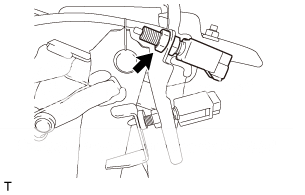

Originally Posted by pevsfreedom View Post
Well for prosperity's sake here's what the switch looks like (I think?)
I think you're more looking for this part...
I would just make sure that it's plugged in securely and that you can depress the plunger.
It's possible that the lock nut has backed off and the plunger is not being depressed all the way / far enough.
Since you're still under warranty get it back to the dealer and get them to work it out. ***** Nevermind, just saw that you have an appointment.
yup, that's the one.
heads up! There are 2 of them, one in front of the pedal and one behind the pedal (with respect to the car, nose=front tail=rear). you want to check the front one.

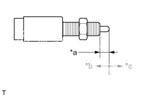

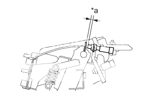

Here's the info on the clutch switches from the service manual. There are TWO switches, a clutch switch and a clutch start switch.

1. Installation of clutch start switch ASSY
(1) Install the clutch start switch ASSY to the clutch pedal support SUB-ASSY with the nut.
Standard value:
Tightening torque=8.0N·m { 82kgf·cm} {5.9ft·lbf}
(2) Connect the clutch start switch connector.
*a - Clearance
(3) Measure the gap shown in the figure with the clutch pedal fully depressed.
Normal clearance : 3.5 to 4.0 mm {0.138 to 0.157 in}
2. Installation of clutch pedal support SUB-ASSY
3. Installation of clutch switch ASSY
(1) Install the clutch switch ASSY to the clutch pedal support SUB-ASSY with the nut.
Standard value: Tightening torque=8.0N·m { 82kgf·cm} {5.9ft·lbf}
(2) Connect the clutch switch connector.
*a - No gap
(3) Check that a gap is not created when the clutch pedal is not depressed.

1. Check of clutch start switch ASSY
(1) Measure the resistance between terminals when operating the shaft.
Captions in illustration
*a - 4.0 to 5.5 mm {0.157 to 0.217 in}
*b - ON
*c - OFF
Resistance
When shaft is pressed in (ON) - Less than 1 Ω
When shaft is not pressed in (OFF) - 10 k Ω or more
