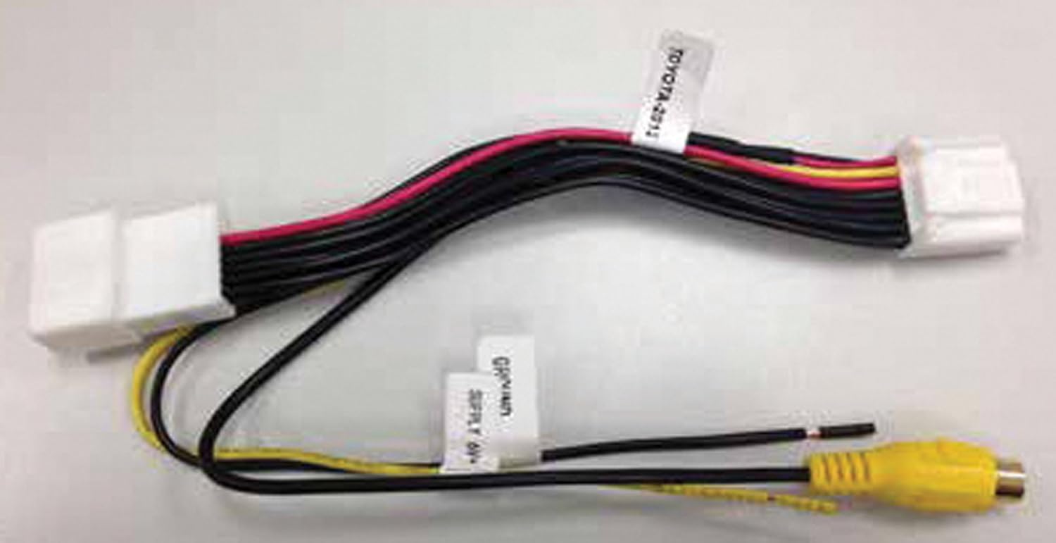

Originally Posted by celica73 View Post
Any thoughts on how [PAC Audio's CAM-TY11 harness] compares to the SVXdc harness?
I haven't seen one in person, but from various pictures around the 'net, theirs provides the CGND (ground) and +6V leads, like mine.
Pictures of the initial version of PAC's harness show they originally only passed through the parking brake signal from car to HU...
Name:  PAC CAM-TY11 old.jpg
Size:  61.2 KB Name:  PAC CAM-TY11 old 2.jpg
(red lead with label). BTW, the core wire of their RCA cable is also red.
Later pics (like your Amazon link) show PAC's now passes through all of the other pins -- everything except for the 4 pins for the camera (RCA jack, CGND, and 6V).
BRZ and GT86 don't need all of those other leads passed through. Most FR-S models don't even need the parking brake pin connected.
On both versions, they don't ground the HU's parking brake input. You would want that if you also plan to do one of the VSS hacks to bypass the in-motion lockouts.
PAC's harnesses appear to have cheaper-quality Chinese shells and terminals (like autoharnesshouse's), where I'm using OEM-quality Japanese connector shells and terminals.
As 6pack suggested, if you choose a camera that works from 6V, it's easiest (and best) to simply power the camera from the HU's 6V lead.
If you have a camera that needs more than 6V, I think it's better to grab 12V from the car's Option Connector harness.
One of these days, I'll work out a circuit you could use for a solid-state switch (transistor) instead of a relay.
ADDED: I forgot to mention: PAC's instructions say "no reverse trigger is needed." That's true for BRZ and GT86, but not correct for FR-S models. That's one of the reasons I ask people what car and HU they have -- so I can determine whether they'll also need the extra reverse gear signal lead.
ADDED: I've heard from at least one BRZ owner from outside North America whose car did not have the reverse gear signal lead present on the factory harness, but his factory-fitted HU did not have rear camera capability (no display).

Ok so i have a pioneer 5100nex and a Rydeen Miny camera. I connected the power and ground to the amplifier as other people have recommended but i can't figure out where to connect the reverse light wire.
I read a previous post that said connect it to a red and blue striped wire down by the steering wheel footwell in the panel down there. But now I am finding other posts saying that its the orange and white striped wire while others still say it is the pink wire.
upon connecting the red and blue wire the camera is always on and I can't turn it off no matter what i do. It won't even let me interact with any other function of my headunit.
Worst yet every write up says splice a different wire and they all seem to be getting it to work.
I know that the violet and white striped wire on my radio is supposed to go to the reverse lights can someone please tell me.
what wire do i need to splice into to get my camera to switch over when its in revers and switch back when it comes out of reverse?
Pink wire, pin 5. It is the fifth wire from the top on the left most row of the big connector under the panel where the hood release is. Did this last night.
HOWEVER, if you have a BRZ you shouldn't need to do this. Only the FR-S needs this; the BRZ has this connection to start with. Check in your head unit diagnostic screen to be sure.
Any thoughts on how this compares to the SVXdc harness?
PAC CAM-TY11
I confirm that I was able to use this PAC harness on to install the Rydeen on my '15 BRZ Series Blue (Limited).
It does have wires for all the pins which is definitely overkill and bulky but I needed it asap so I ordered through amazon prime.
The one I got is updated from the one in the post above as they changed the color from the 6V wire from yellow to Red which matches the Rydeen cable colors. It also includes a male yellow RCA connector that comes from the other side of the harness. You could connect the two RCA plugs to pass through the video signal as any other wire.
I implemented the Parking Brake bypass hack by cutting the parking brake cable on pin 6 and connecting the radio facing half directly to the lose ground cable from the harness. The Rydeen camera ground is plugged back in the trunk area so the harness' one is not needed and free for this.
Just as a note, the autoharnesshouse kit has the parking brake already bypassed. That is what I used for my install and it works well!
