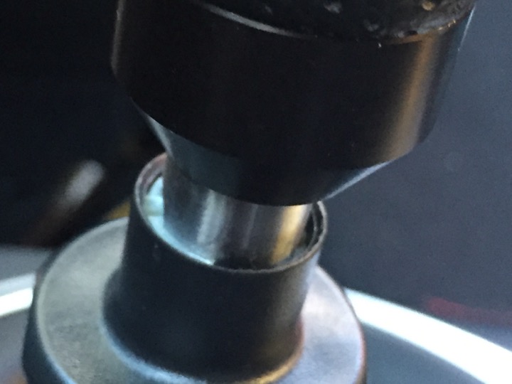

So I put on a MOMO Shadow Carbon (fake look) today, I was debating on wether or not to go taller but I searched and knowing MOMO's quality and simplistic look I went with this one. I got it from Japan which even with shipping was slightly cheaper than in the US. So I start installing and major problem, the bottom collar where the reverse lockout lever goes into on the stock shifter is way too small and the lockout wouldn't go up into the MOMO collar. The white plastic slider inside the lockout I was able to clear but the black collar on the lockout was way too wide. So I ended up, after many hours of modding, removing the black lockout lever and cutting the white plastic slider at the top cutting just enough where the center of the white slider will let the roll pin move in. The reason I cut it is that it shows when the MOMO is installed. So I then reassembled the lockout put the lever in reverse and left a slight gap between the collar and the top of the lockout lever, when in normal driving the white plastic that would be showing is gone and the polished metal just shows with a little bit of the roll pin slide are. I like it too, looks more mechanical or something. So here are the pics...

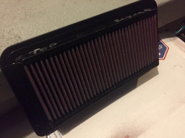

Just put in a K&N filter I got from on here only a few hundred on it. Had the cleaner kit already and oiled it up! Not bad for $30

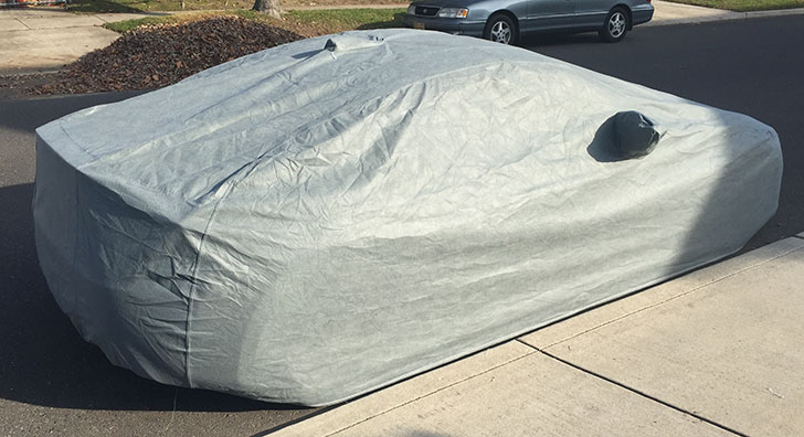

Got a Exact fit Coverking Coverbond-4 cover to protect my investment during bad winter weather!

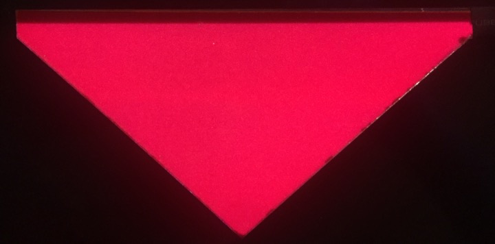

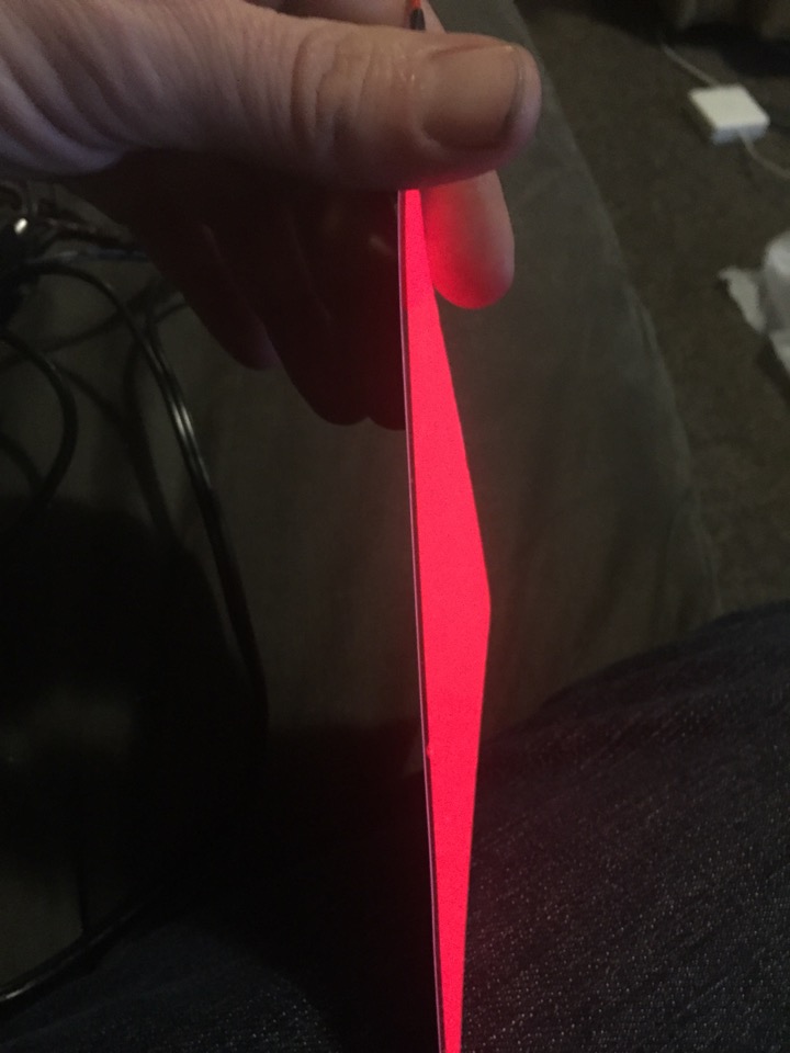

So i found someone that cuts EL to custom sizes. Since I always wanted the rear red fog to be lit I figured EL would be very different. In the pics you can see how it looks when dark out. I will take another pic in the morning for daylight visibility. The light is 100% even and it looks futuristic in a sense. I'm anxious to get it permanently mounted and have it always on when the car is on.
Pics show;
1. cut and lit piece
2. showing thickness
3. EL tape lit
4. Not lit

I wonder how it compares to a regular bulb. is it bright? and how would you apply it to the rear triangle? I currently have a bulb lighting it up.

It's not very bright, about 1watt. It looks brighter because of the light being so even. Hard to compare to a filament bulb

Fitted my car cover the other day... fits great!

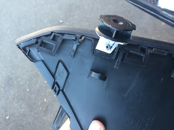

So i deleted the Sharkfin antenna and put on a cover over the exposed hole. I just never liked the look of the antenna and I can't afford to put out the $$ to have the hole welded up and the roof repainted. So I used a center console carbon fiber plaque I bought but had a change of design so it left this piece free to do whatever I wanted. It was quite easy and if you just use the DS 3M tape it will take you longer removing the antenna than installing the cover.
So here's the easy way...
Purchase Plaque
Remove antenna
Clean underside with Acetone or rubbing alcohol
Apply tape closest to the edge of the plaque as possible, keep on red release tape
Place plaque over hole centered best you can also looking from the rear that it isn't twisted. Once set gently hold the plaque in place and mark with sharpie (will come off after install) I used silver for dark surfaces.
Make marks at multiple X and Y on the edge of the plaque and paint.
Remove plaque, wipe plaque area with rubbing alcohol and then apply outdoor waterproof silicon (at home Depot made by GE) just outside the perimeter of the hole on the roof.
Remove red tape and while standing on the door sill lightly place plaque against the marks you made.
Once you line up the marks on the plaque to the roof marks press firmly down and hold for 30 seconds. Don't push hard as you could bend the metal of the roof.
Reassemble headliner.
This will come off if you wish to color match later. It will need a base coat and a clear coat.
