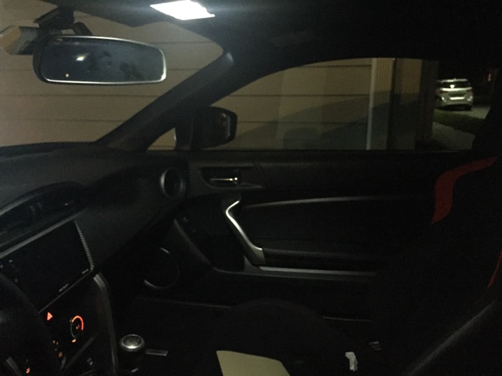

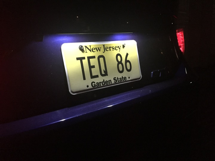

Got some Phillips LED's for dome and license plate. Just sidemarker, reverse and fog light left.

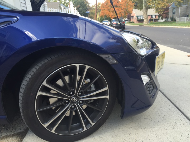

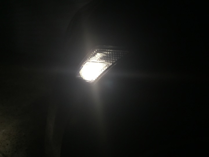

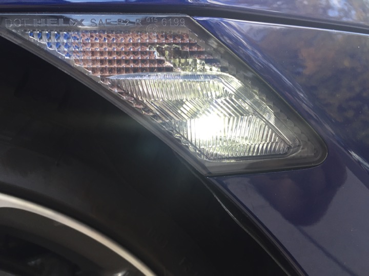

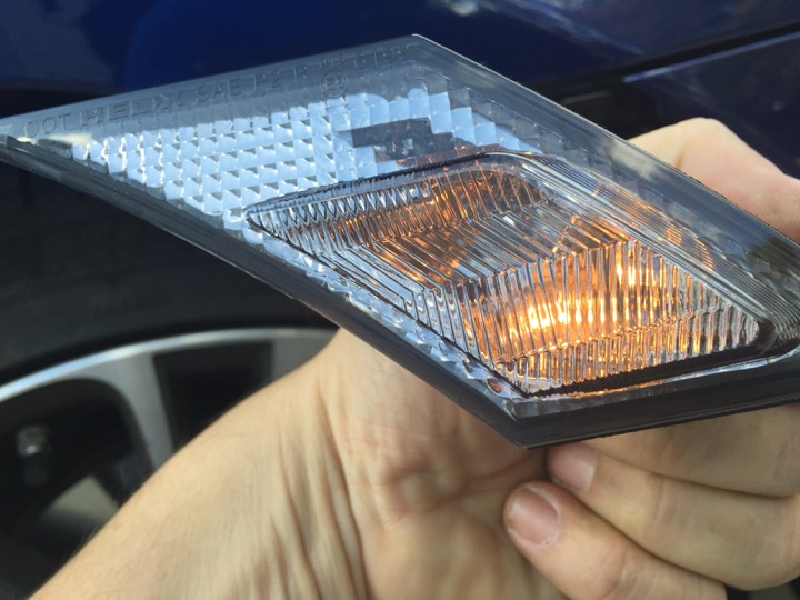

Was surprised and received my Light Smoke Helix sidemarkers, finally got rid of those ugly amber markers The first pic is the OEM bulb with the marker then with the LED, also the light smoke seems to blend in nicely with blue, and a night shot :] Just backup and fog light left to go and I'm 100% LED

Well I just guessed on the 1st try and found out it can be done with just a long flathead. I removed the plastic clips in front of the tire just under the marker that holds the wheel well to the fender. It's a flexible plastic and you can move it out of the way. From below using a ling skinny flathead I just pressed on clip "A" marked on the new sidemarker and twist the screwdriver to slightly pop the top of the marker and once you got a hold of the top I firmly pulled down ant the other two clips let go. Thats all.
