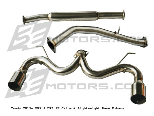

Originally Posted by HachiEnam View Post
I'm more than sure it is the exhaust. I've had an inlet tube installed for a couple months not, but thank you for helping .
Isnt the tsudo catback resonated? It looks like it. This is the catback I have:
http://www.ft86club.com/forums/showthread.php?t=25062
I have stock FP ofc
Thank god you didnt get this one or drone would've killed you:
That legit is a dual exit muffler delete, that plus uels would've been killer
