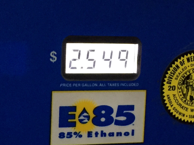

In regards to cold starts and first time using Ethanol, would intentionally leaving an extra gallon or so from gas light be a bad idea since the ecu is getting used to e% in general? I ask because it's been in the low 50's where I live and don't want to have cold start problems until I can add some petrol to taper e%. Idk exactly what percentage of E the pump has this is a pic of it helps determine anything Name:  ImageUploadedByTapatalk1446447577.127944.jpg
Any advice helps.

In regards to cold starts and first time using Ethanol, would intentionally leaving an extra gallon or so from gas light be a bad idea since the ecu is getting used to e% in general? I ask because it's been in the low 50's where I live and don't want to have cold start problems until I can add some petrol to taper e%. Idk exactly what percentage of E the pump has this is a pic of it helps determine anything Attachment 124152
Any advice helps.
Shiv said the tune is good for between about 60% and 90% ethanol. if your fuel is guaranteed e85% then no problems adding a gallon or so of petrol to a full tank for easier start. Also you cam modify the cranking IP W tables in tune for better starting in cold weather as well ,do both of those and you should be good down to near freezing temps
