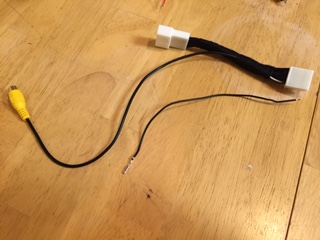

Here are the 3 pieces that plug and play together.
1. 16 pin harness that plugs into the back of the headunit.
2. male to male video cable with power wires on each end
3. female video input cable attached to a camera with power and ground wires.
remove headunit
unplug factory 16 pin harness
plug in new 16 pin harness
plug original 16 pin harness to the extension of the new 16 pin harness
plug yellow male video input into female input
tap red wire to a 6V+ wire on the factory head unit. (i used the ACC/yellow cable)
run the wires to the back of the car, under all the carpet and trim
plug the other end male video input to the camera output video
grimp the 2 red power cords together
ground the black wire
drill a whole to the back fender where the camera will go.
screw in and adjust
finished
upon starting the car, place in REVERSE, camera should power on once in gear
