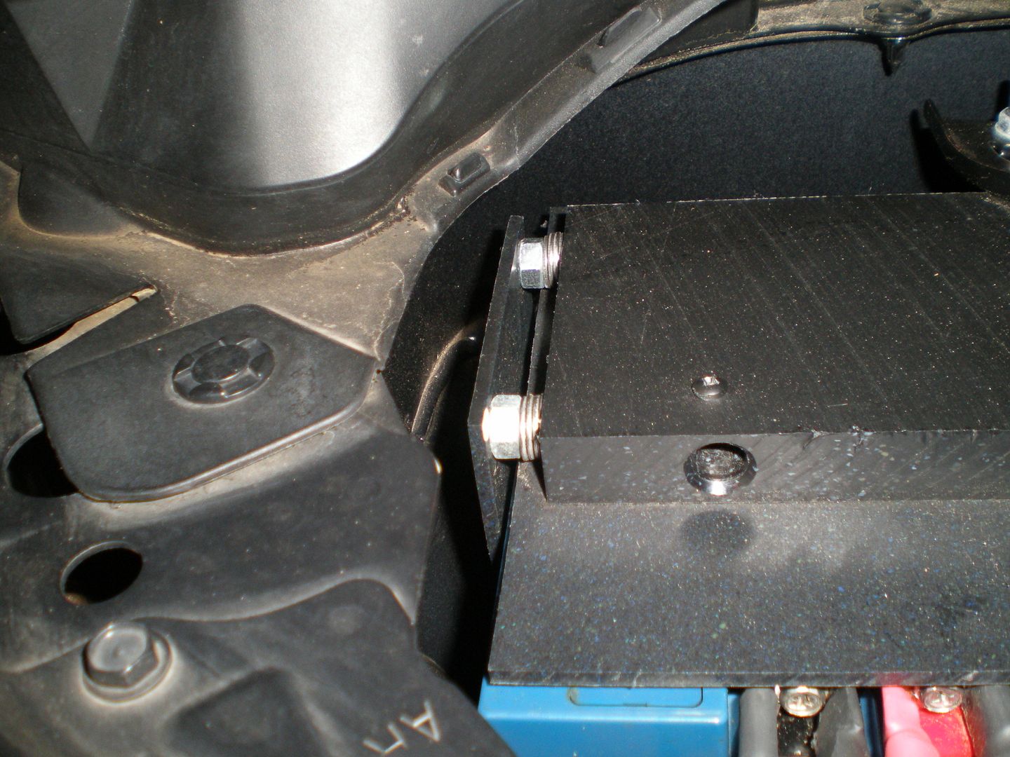

are you still running the original starter battery with the 1.5 setup? I can't remember if it will fit, but you could try out the new starter batt. I managed to get 2.0 to fit with the 1.5 kit with some washers and longer screws between the top block and one of the side braces, plus cutting off the inside lip of the battery tray. If interested I'll post some pics.
Yeah, still running the original starter battery with the 1.5 dump pack. Some pics would be great.

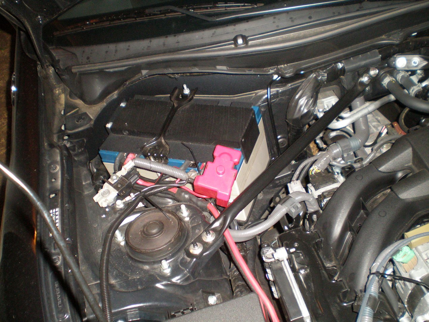

My layout is pretty much the same, the dual dumps are just about 1/2'' wider than the battery tray and brace.
I forgot the nuts, I just used whatever I had around that would work as a spacer, and used some longer screws.

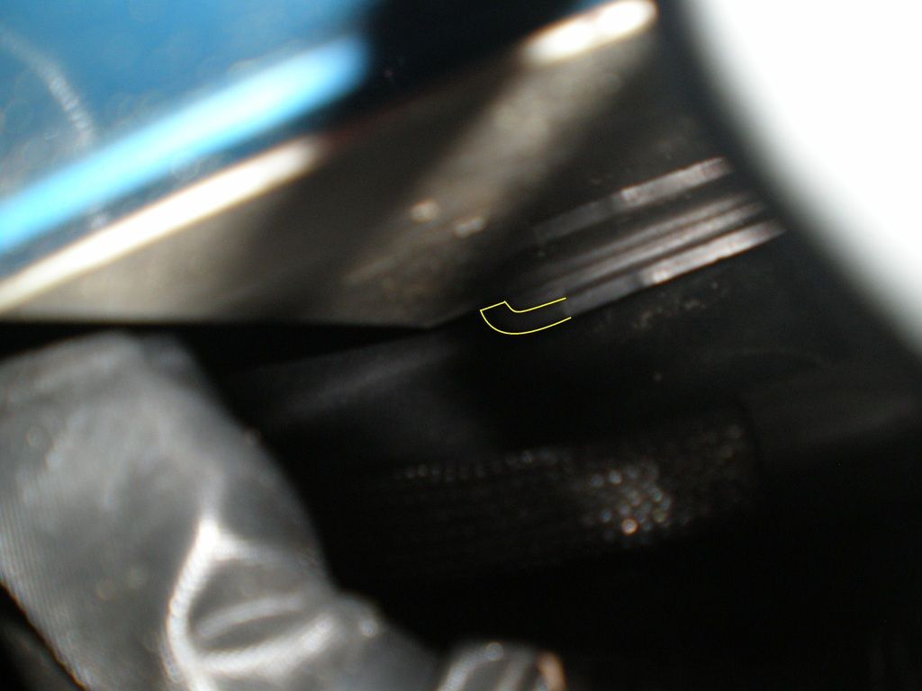

It's dark and really hard to see, so I highlighted the end of the tray. I just ran it through a table saw and cut the lip off the side so the battery could overhang.

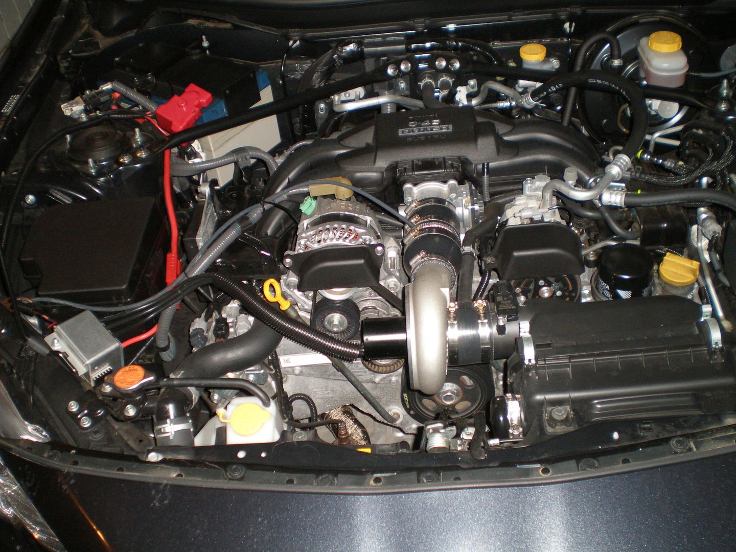

I installed a second hand USA kit from Gary in NJ, and made longer cables to fit RHD in Australia. Thanks Gums for giving me the dump cable and to dtek for converting the USA tune for my A01G ROM.
I converted the throttle switch by reversing the folds of the bracket. I plan to get the Procede soon.
The cables are in a temporary position until I decide the final length and location, probable under the manifold.
