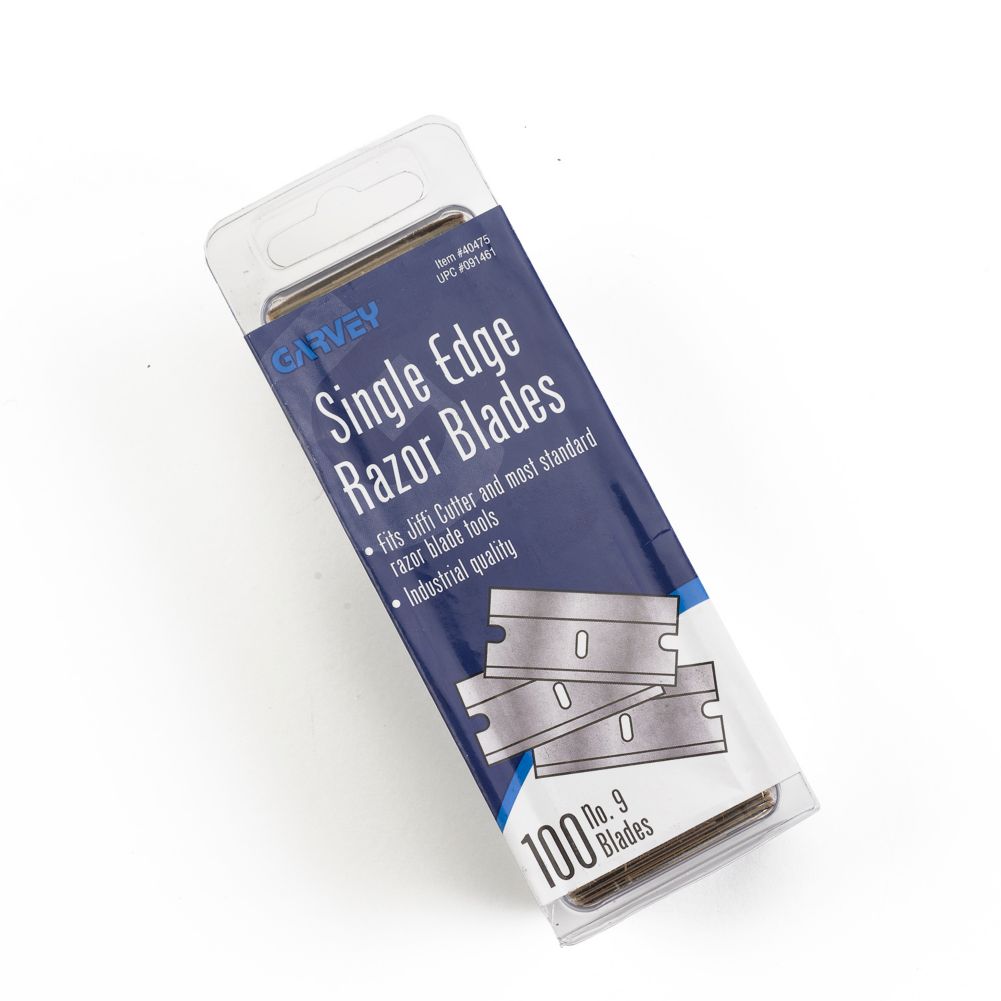

In a small are wet down glass with car wash soap and water mixture in a bottle. Saturate the area and glide a box cutter blade over the area. Be gentle and float over the area and press slightly firmer. Wipe with a a MF cloth and see how it looks. Could just be road paint spray. Was any on the paint?
