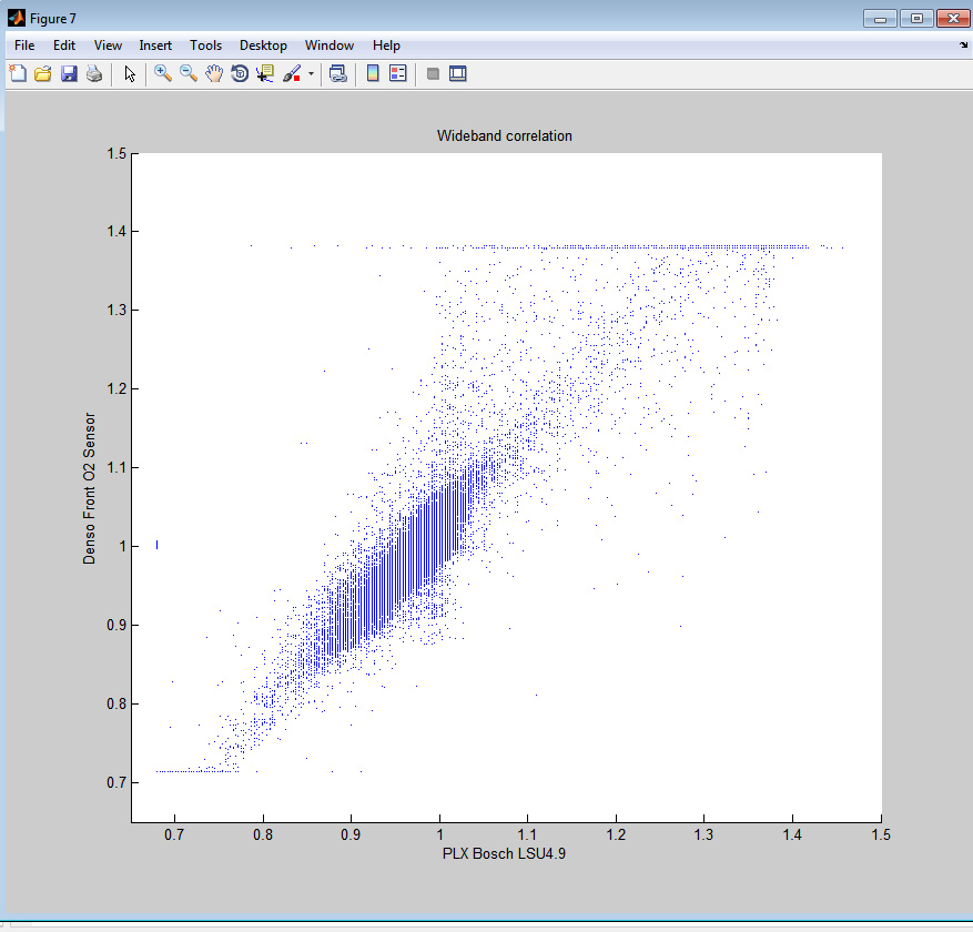

Only got around to it today:
I had a look at the Bosch 4.9 and Denso curves - they are quite similar in mA vs lambda measurements. Our stock ROM reads quite close to the Bosch curve x 0.61.
Made an extended table for the front O2 sensor scaling that is shown below (working down to a 10.5 limit, next testing a 10.0 limit).
The results of that curve vs a PLX SM-AFR (installed last week) with Bosch 4.9 wideband (units in lambda with range from 0.68-1.38) attached. I think that with the extended scaling, the Denso sensor actually performs quite well. The ECU sensor has a smoothed output and I think that is responsible for the higher variability on the lean quadrant of the chart when switching between fueling and deceleration cut.
