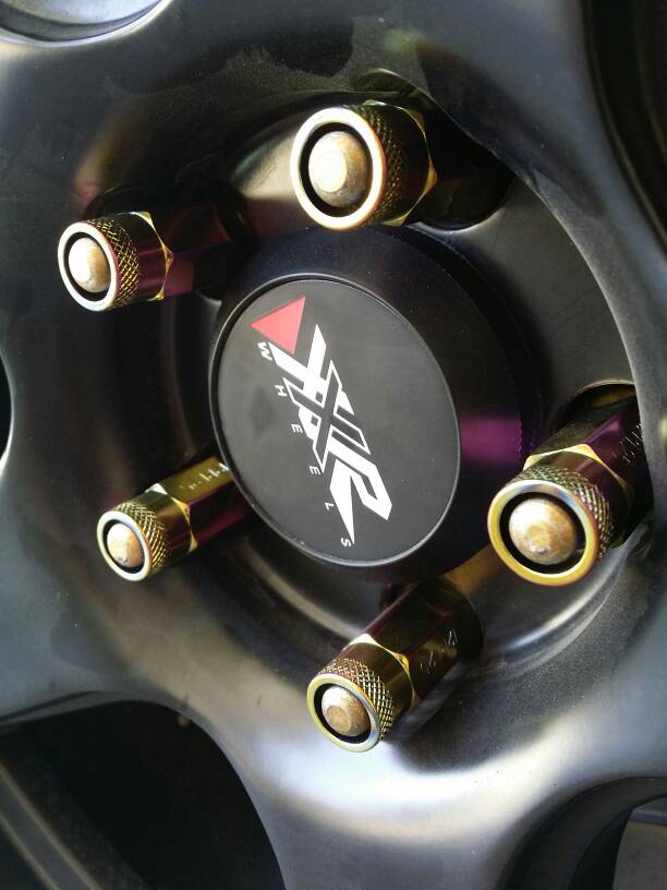

texasbound972 is offline   Reply With Quote
Old 07-28-2014, 10:25 PM   #92
texasbound972
USMC
texasbound972's Avatar
Drives: 2013 FR-S 6-MT Raven
Location: Hemet, Ca
Posts: 639
Thanks: 362
Thanked 161 Times in 128 Posts
APR studs with Muteki neo chrome lugs
