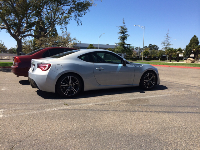

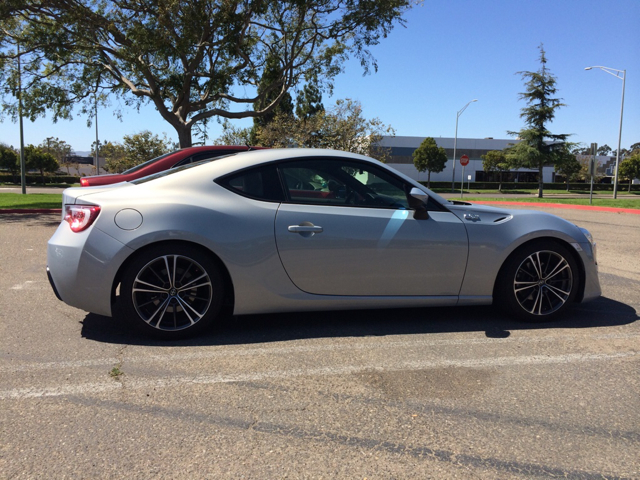

Eibach sportlines with 20mm up front and 25mm in the rear.
Size:  391.6 KBName:  ImageUploadedByTapatalk1410468726.794277.jpg
Size:  341.0 KBName:  ImageUploadedByTapatalk1410468740.195535.jpg
CenCali86 is offline   Reply With Quote

Attachment 90609Attachment 90610Attachment 90611
Have you noticed any differences in handling? Also, do you track with this set up?
