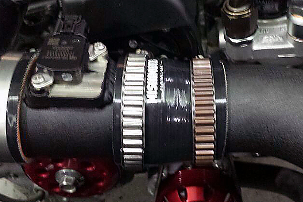

Got my Mishimoto CAI and silicone induction hose installed today. My garage mentioned that I should use additional clamps (that were not supplied with the kit) to make sure the intake pipes stayed fitted (4th picture attached). I was thinking these would be unnecessary, but erred on the side of caution and purchased them anyway.
Biggest benefit? Finally removing the entire noise generator assembly! Engine bay looks much neater now. Car has a much deeper sound as well, compared to previous stock air box with K&N drop-in.
