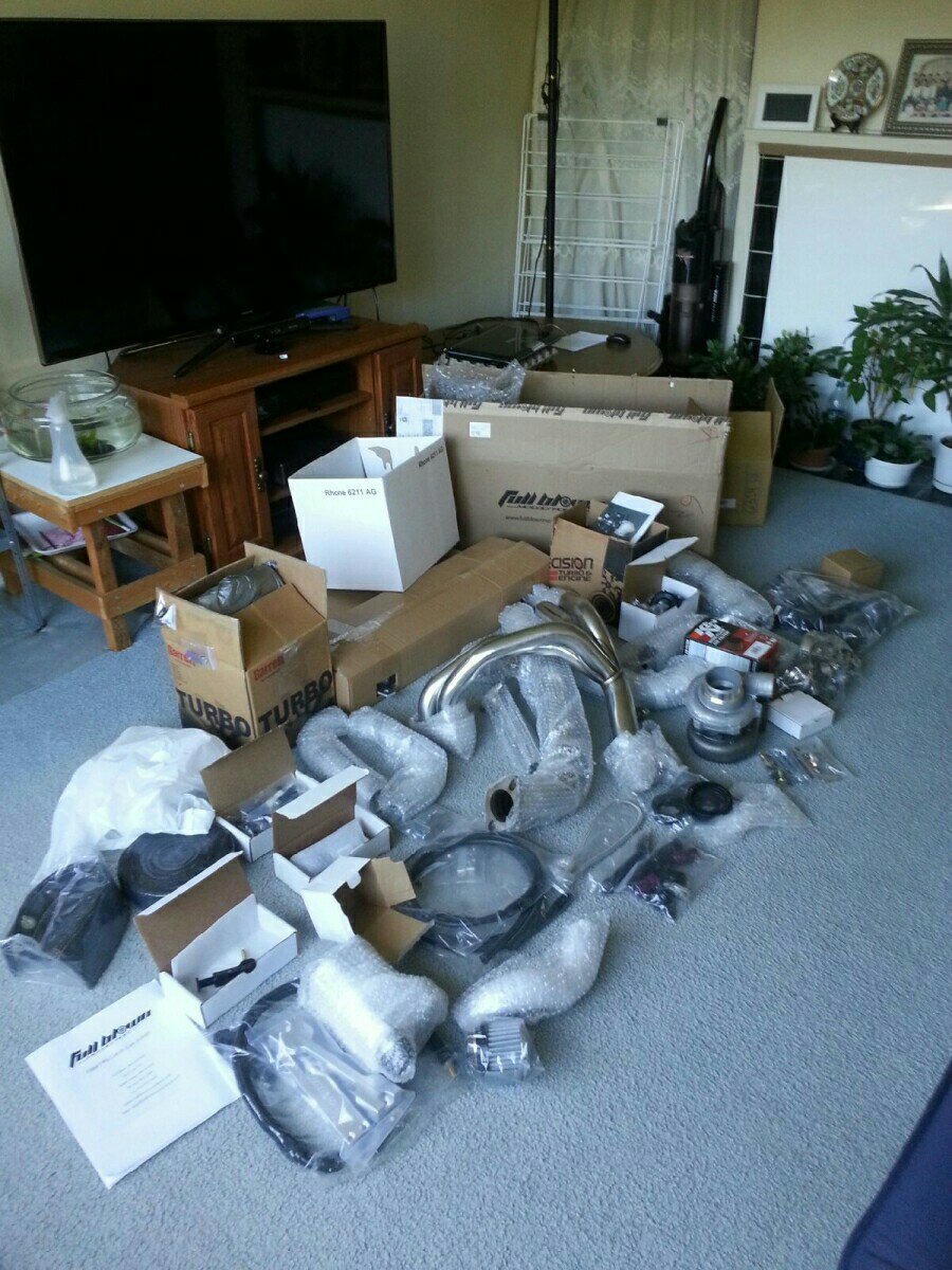

And it begins

Originally Posted by mashal View Post
Attachment 77496
And it begins
I wish i could make it there in time to help!
No problem ! I'm sure I'll need your help eventually haha , I'm gonna message you on fb
