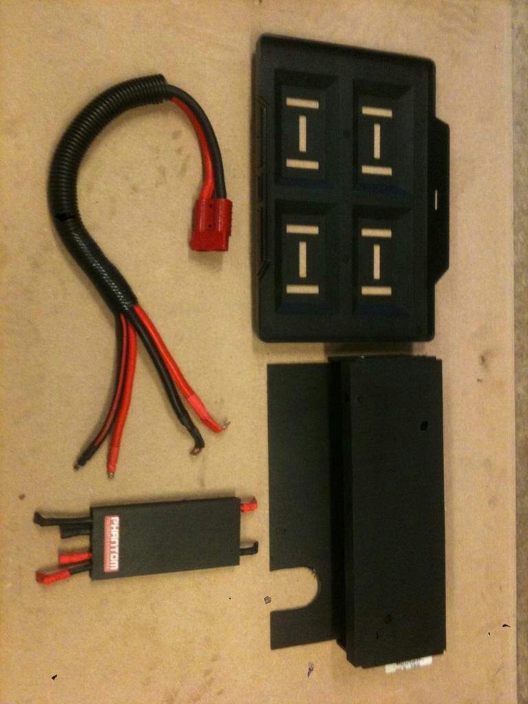

Here is another picture of the conversion kit and how it all looks when grouped with the other dumps. Rob has created a very clean installation.
Sent from my HTC One using Tapatalk
Attachment 76059
Attachment 76060
Here's how it looks installed for people to get an idea how it looks when its done.
