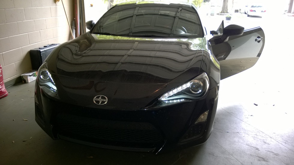

Originally Posted by -Ozzy- View Post
Installed mine today. No fogging yet.
It's been 2 hours.
Attachment 72656
They will normally fog up under really cold conditions

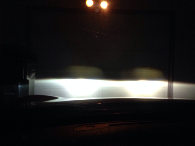

I took a second shot of the stock winjet projector light cutoff with 5000k ddm hid kit and my switchbacks covered. I didn't realize how much light scatter the switchbacks showed on the garage door. Name:  ImageUploadedByTapatalk1396553720.509812.jpg

Originally Posted by beaver_scott View Post
I took a second shot of the stock winjet projector light cutoff with 5000k ddm hid kit and my switchbacks covered. I didn't realize how much light scatter the switchbacks showed on the garage door. Attachment 72988Attachment 72989
The Z's should line up to make 1 Z not 2
Yours:
Z Z
Should be:
Z
also, mine came in today. look great. going to wait to retrofit.
@everyone asking about DDM, I had some horrible experience with them. Had them on my FJ for a while, but had one ballast intermittently not turning on. Always a PITA when you have to keep flipping your lights on and off again to get the light to turn on. RMAd the thing, new ballast, same issues.
I would suggest not cheaping out and going with something from the retrofit source. high quality stuff there.

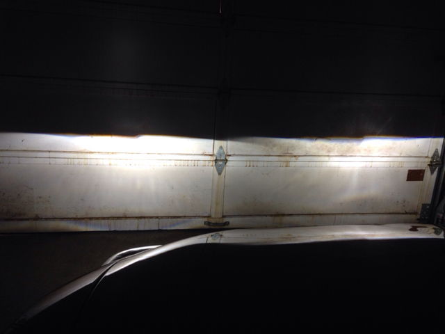

Are you sure about that? Here is a shot of my stock headlights and factory aim has "Z Z" patternName:  ImageUploadedByTapatalk1396568282.655450.jpg
Are you sure about that? Here is a shot of my stock headlights and factory aim has "Z Z" patternAttachment 73023....
They might night have to align, but they should be much closer than yours IMO

I'm sorry but I can't let bad information like this stay out there.. There should be two "Z" and they should be the same distance apart no matter how far away your car is from what ever they shine on.. So if your headlights are say 5 feet apart, those "Z" or steps should be 5 feet apart at 1 foot from a wall of 100 foot from a wall.. Or 1000 if your lights are good enough to form that cut off..

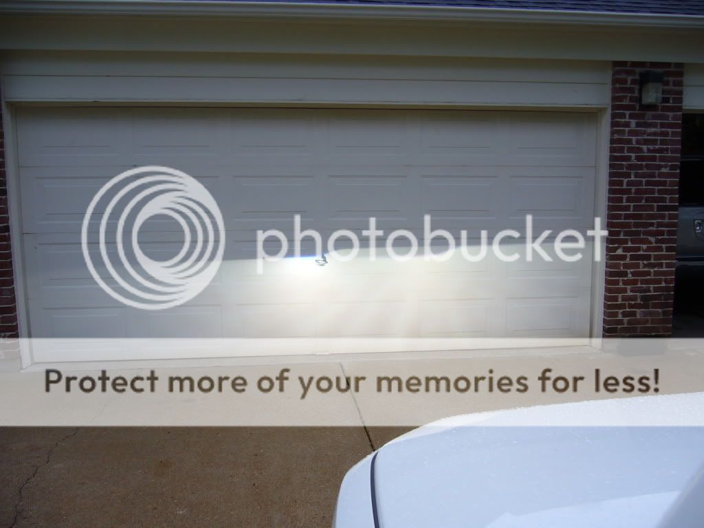

Nope, they should line up much more than his original post does. In his post they are completely separate and from not far away. I was wrong in saying they should be on top of each other, I was thrown off by how his looked I guess I had forgotten what they should actually look like
Should look more like this
vs his
okay maybe I originally underestimated how close his car is to the garage door. It is a bit deceiving.

I see what your saying now.. There still should be two steps, tho in our case the left one should over lap the right one.. And I'm sure his come close once he backs up some, but the winjet projectors don't make that great of cutoffs to begin with.. They do slope down.. I read your statement as both of those steps should become one..
