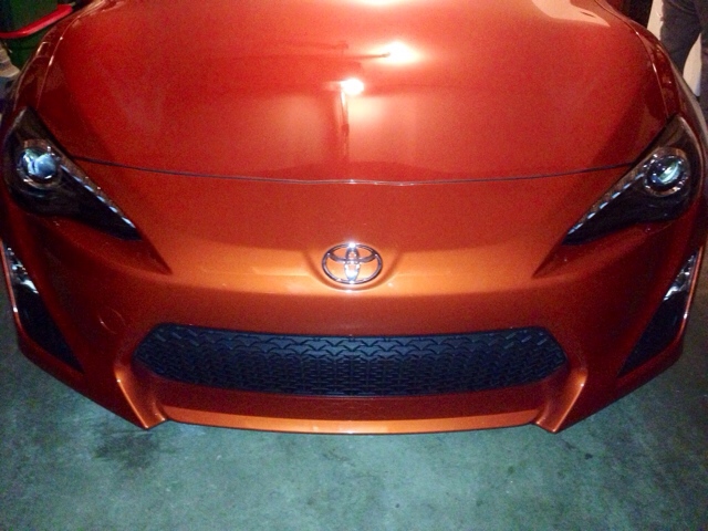

For you guys worried about fogging...some fogging during the first few days after installation is normal. If you do choose to bake the headlights to take them apart...about 200 deg for 8 min should do the trick. Get the 3m window weld to use for the new sealant (works better than silicon sealants). The 3m window weld has never leaked with my projects. For the guys wanting hids for their winjets...just get a set of hid bulbs and don't bother with a retrofit. Ive done retrofits before and believe it or not my winjets have great light output, aim and cutoff with hids and no retrofit.
Size:  222.9 KBName:  ImageUploadedByTapatalk1396404305.735195.jpg
Size:  137.2 KBName:  ImageUploadedByTapatalk1396404326.735282.jpg
Size:  225.7 KBName:  ImageUploadedByTapatalk1396404341.868752.jpg
