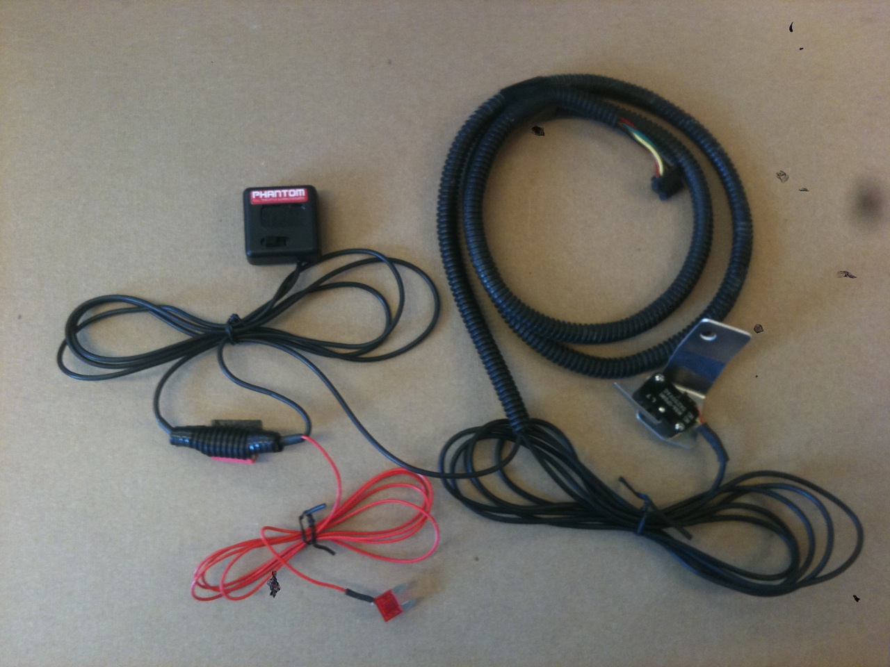

Name:  harness improv.JPG
@BuTang and I installed this new harness.
- auto on/off relay integrated into cable
- tint/diffuser on digital display
- one wire with ATM fuse for switched +.
We found a great switched source located in the fuse box under and to the left of the steering column. The ATM fuse just plugs into a vacant spot! The relay sits in the pass-through in the center console about 2 1/2' from the fuse box.
I will be adding this to the kits as well as routing instructions to the install manual.
THANKS BUTANG!!! (~10 mins for him to install and tuck/ zip tie)

Nice work.

Will this be available for the early adopters who already purchased a kit?
