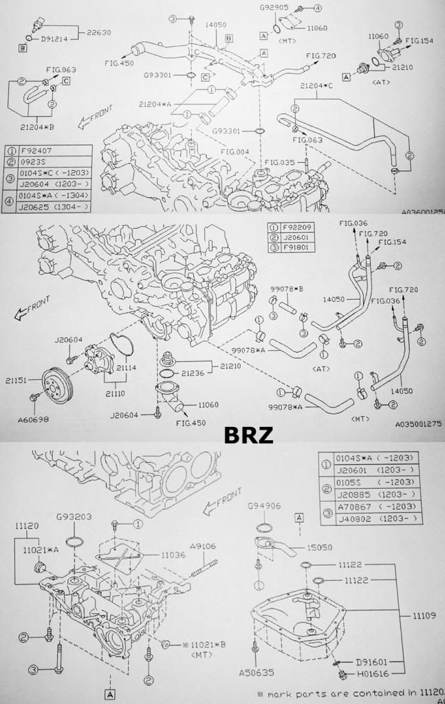

Is there anyone reading who can help me get some part numbers?
I want to (if possible) use the auto trans cooling nipple shown in the top figure, see 11060, Fig 154 <AT>. My car is MT, so I am hoping that I can swap this out for the blank off plate shown for <MT>. What is the part @ 21210?
Cusco appears to be doing this too. See below.
