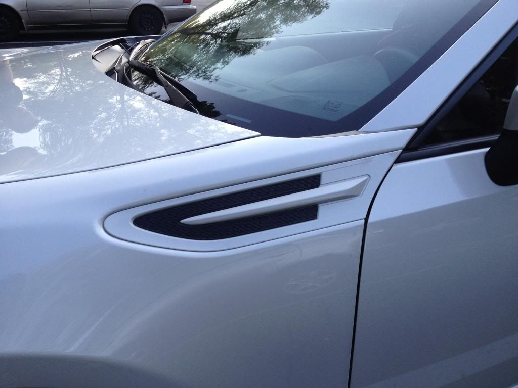

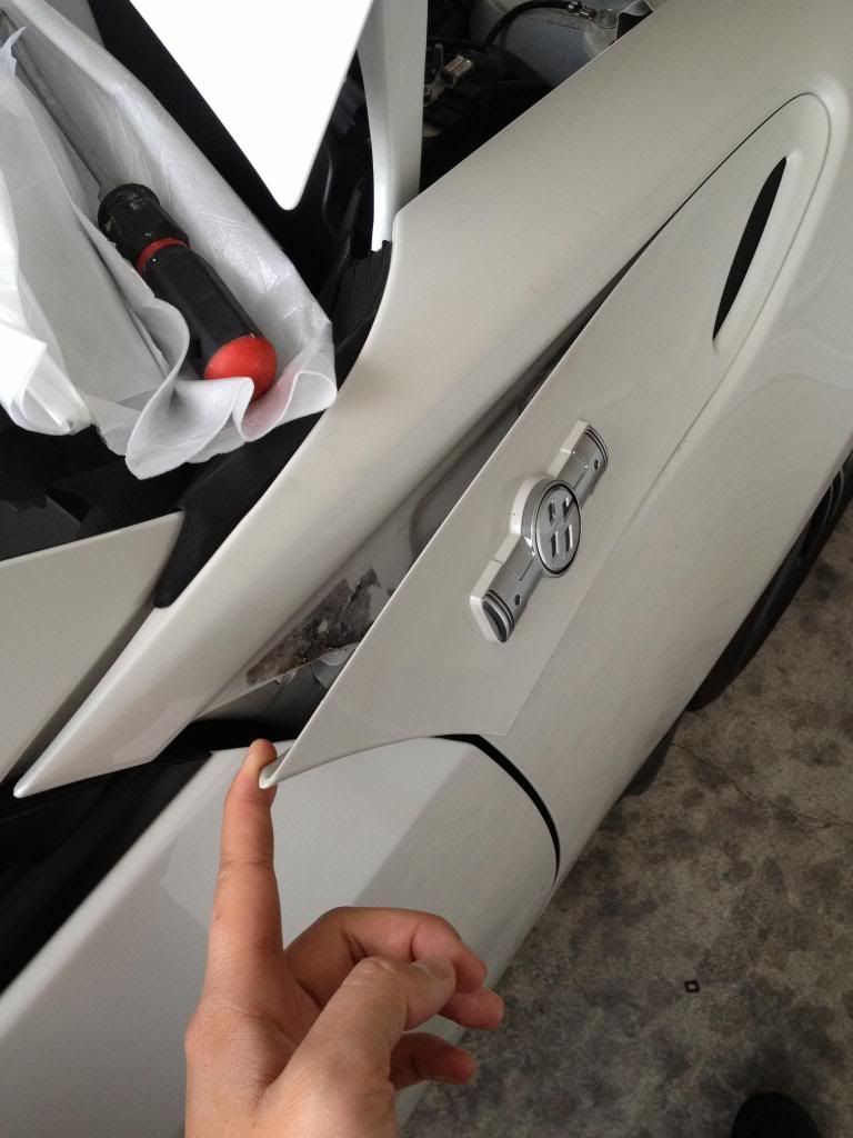

I know this is late lol xD but !! and random, but i swapped these out to put in the BRZ ones into my FRS
there are adhesives on there.. and some clips thatll pop out, but use needle pliers for the side thats under the hood.
