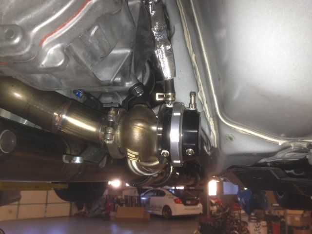

Some photos of the turbo exhaust piping / downpipe / waste gate. Tonight I'll completing the exhaust piping. Remaining items for the turbo - oil scavenging pump, intercooler and piping, intake piping, BOV, vacuum lines, ECU reflash etc... If all goes well I should be starting her up this weekend.
@RB6freak, I recommend you reposition the WG barb fittings to make sure the boost line is away from the bottom of the vehicle as shown below:
MrC
MrC
Thank you sir. Will revisit this tonight.
