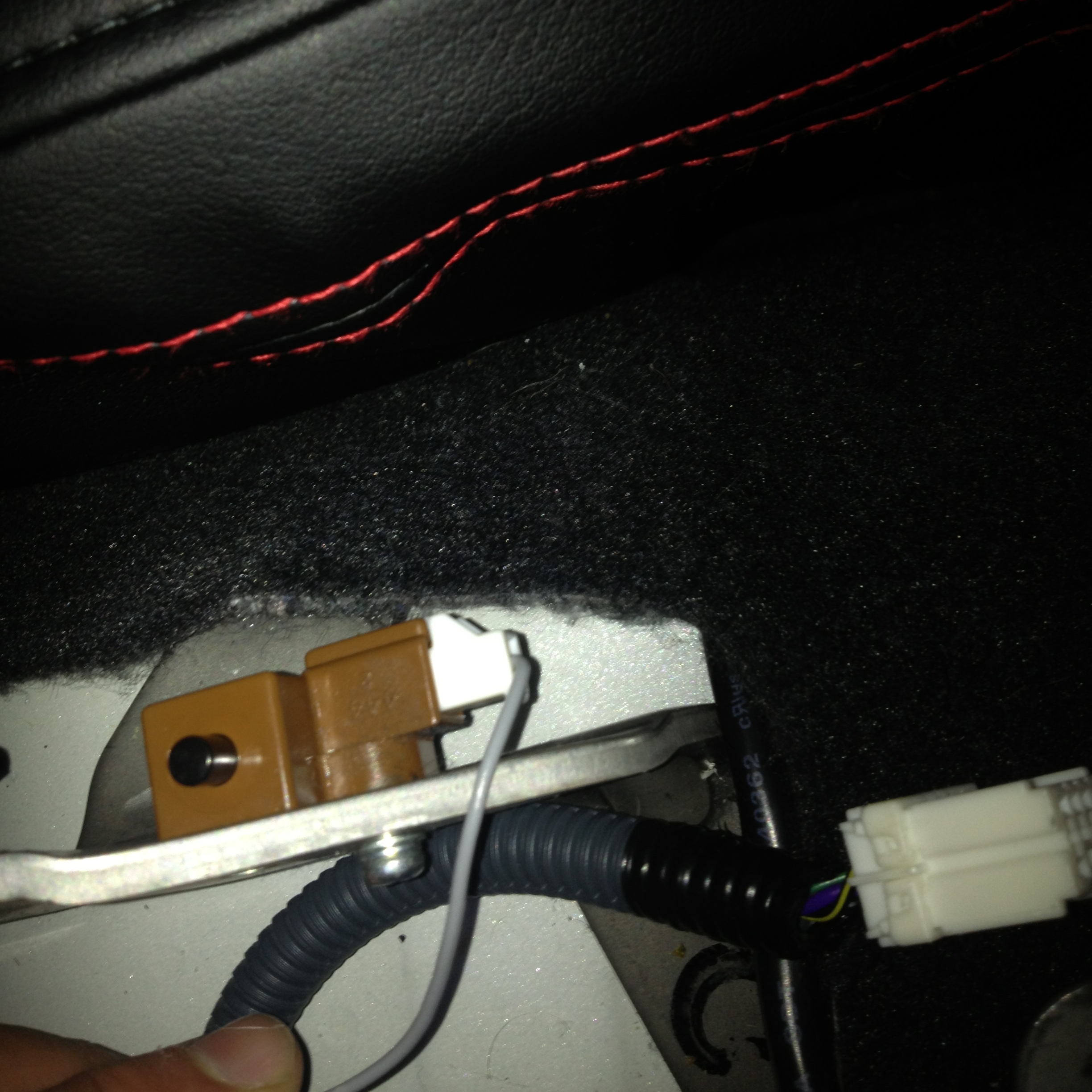

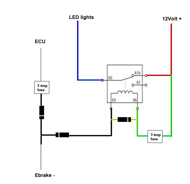

So after having these on the car for a year, I decided I don't like having the lights on while I am just sitting in the car with the radio on. I installed it originally like the OP describes, and had tapped into the cigarette lighter behind the glove box. So, I hooked up a relay attached to the parking brake wire which interrupts the power to the led lights when the brake is engaged.
This is the wire I hooked into, it is just under the ebrake.
Here is the wiring diagram for what I did is attached
As you can see, there are several diodes and inline fuses. It may be overkill, but I am paranoid about shorting things out. Basically, when you pull up the ebrake negative signal allows the coil to be energized, which switches the power from 87a to 87, interrupting the power to the lights. Put the brake down, the coil loses energy and flips back to 87a, powering the lights again. It works like a charm. The diode there with the yellow wires prevents a spike when the coil collapses.
