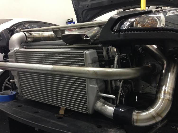

Originally Posted by mad_sb View Post
Hey,
You know that IC core mounting has the flow going opposite the way it does on the OEM application? Not sure it will matter as i don't recall the fin layout on those cores but just thought i would mention it... Stock application the charge flows in the vertical inlet and out the horizontal...
Assuming the core is non directional, that is better routing than most kits i have seen. Is there room in the bay to clock the compressor housing about 80 degrees so that the charge pipe comes off under the filter?
I've never heard of a directional core. From cleaning it out after the welding it flows the same either direction as far as I can tell. I certainly plan on replacing the intercooler with a better aftermarket core. The Evo core was only used to save some cash. IC cores are pretty expensive.
I could spin the housing around but then that would put the piping closer to the hot manifold and the external waste gate. It would also ad another bend to go up and over the frame rail.

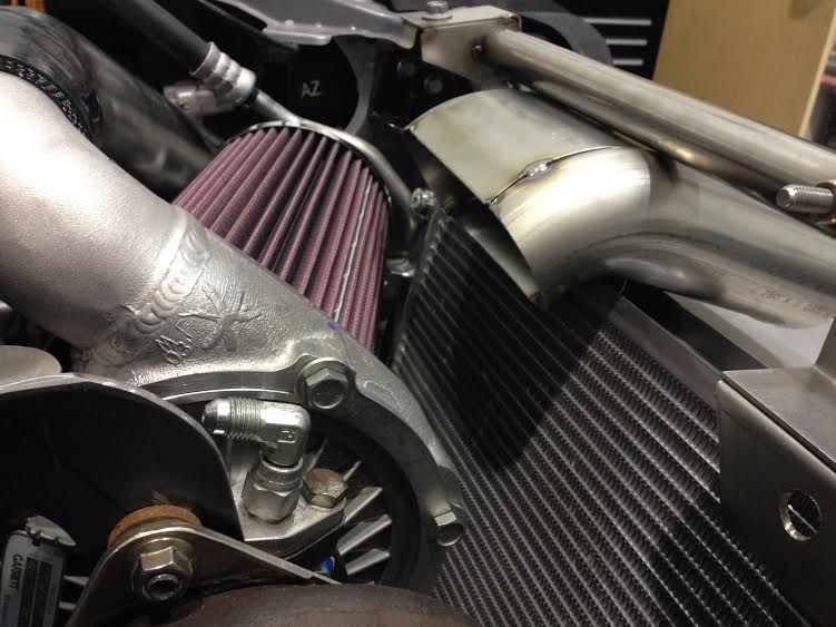

Stole a little time today for the BRZ. Since I plan to leave the filter right on the turbo I wanted to build a fresh air duct. Also ordered a bunch for parts to gets this project over the hill. Spal fans, TurboSmart clamps, eBoost2 boost controller.
