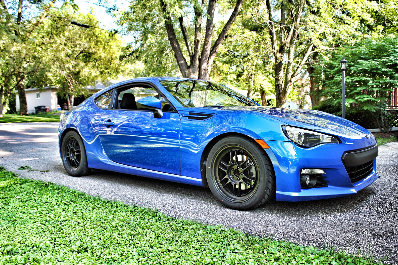

Enkei RPF1 17x8 +45 with Dunlop Z2 245/40/17
Eibach Sportlines
Stock struts (photo), now Koni inserts.
These springs are great. Along with the Koni's I think the give a great feel, and a great drop for not much investment. I've had this same combo on other cars and have always loved it. To me it looks like an OEM height in comparison to other sports cars or sporty cars.
