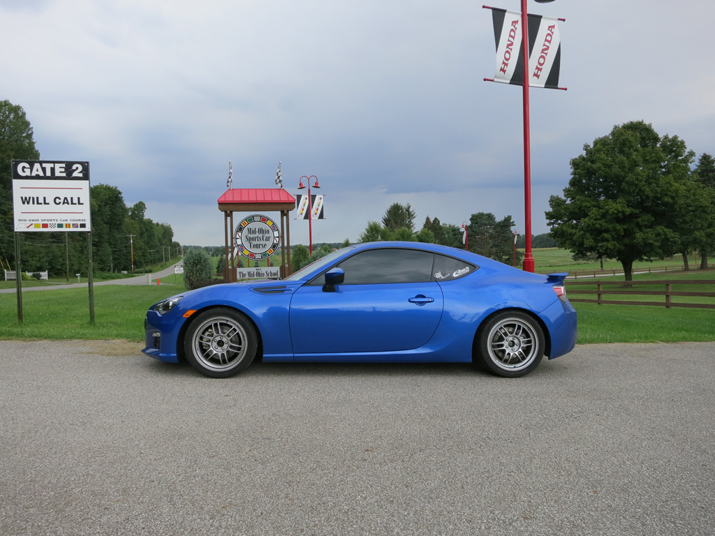

If you've seen Darren's thread on Zach’s car than you already know what the car looks like lowered with these springs, but here's some pics just in case:
And here's Darren's thread with lots of pics of Zach's car:
http://www.ft86club.com/forums/showthread.php?t=15079
There's probably no need for any more pics than that really, I could take some more but it still looks exactly the same a month and a half later
The car looks absolutely GREAT with the aggressive lowering provided by the Sportline springs, there's no doubt of that. The car has only received compliments on its appearance with the springs and the one thing I'll regret when I raise the car back up on a threaded body setup is that I will lose the aggressive look it has with the springs. I run a smaller overall diameter tire setup which makes the factory wheel gap even worse than normal so this setup looks great with the smaller diameter tire setup!
