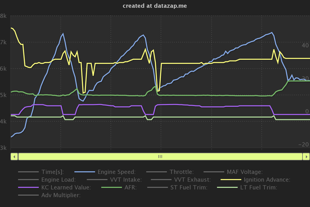

Did my first datalogging data zap today.
I am not tech geek, and it was easy.
1)Hit "start" while in the OFT realtime datalogging window
2)Run through the gears at WOT
3)Hit "stop"
4)Connect OFT to OF Manager
5)Open datalogging
6)Click Export
7)Go to Datazap website & upload file
8)Graph shows up with RPM only
9)Click on the labels to add that parameters you want to see (AFR, LTFT, etc.)
10) Click the little page icon in the upper right corner of the graph to save the current screen as a pic
11)Upload to your preferred photosite for hosting
12)Link photo to here to post it up
Stage 2 E85 run on stock car:
Overall, my car looks pretty happy with AM at 1.0 & KC learned in 5's. The AFR's are rich - lower mid 11's. It's 21 degrees out, and my only mod is a K&N filter - so it my car my not be flowing quite enough air for the stage 2 E85. I would think the LTFT would go more negative with it running rich?
Sterling Doc is offline   Reply With Quote

@StormTrooper to be able to compare you need to do a couple of consecutive 3rd gear pulls or higher over the flattest run you can find. This is done to generate decent loading on the engine. Watch the overall ign timing or knock learned value, if at any point it's not consistent then it's pulling timing slightly. If the values are perfectly consistent in every run then there's no timing being pulled.
Remember that the ECU wont pull the IAM down unless it sees repeated knock conditions. The consistency of ign timing on decently loaded WOT pulls is a much better indicator. This isn't so easy to indicate partial throttle issues though.
@Sterling Doc don't forget that the LTFT's are not added to when running open loop (ie. WOT). They are only affected by consistent STFT during closed loop conditions.
