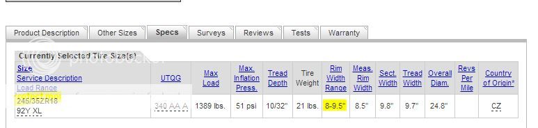

245/35/18 on a 9.5" is within specs.
the extra 30mm does provide additional "grip" reasoanably

245 on a 9.5" wheels will provide a lot less cornering grip then 245 on a 8.5". The gains in straight line grip will be negligible given the low power output
