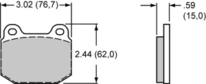

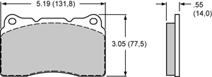

I wish I knew this kit was this easy, I still might go to it down the road. The pad surface area you can get out of this kit is ridiculous compared to most other kits out there.
Just to make sure I have this correct:
Fronts:
Rotors: 328x30mm (Pads: 132mm x 78mm)
Rears:
Rotors: 316x20mm (Pads: 77mm x 62mm)
Front Pads:
Rear Pads:
It also looks like there are quite a few pre-drilled 5x100/5x114 rotors available. It seems like going two piece would easily fix that issue too. I saw a road test (believe by motor trend) that had the STI stopping from 60-0 in 109ft. That's pretty solid and a 600lb heavier car. I'd love to feel the force of these on a BRZ/FRS with track pads/ss lines. I've been impressed by my set up and very impressed by the AP Racing kit. This STI swap seems like a nice option for the price point.
