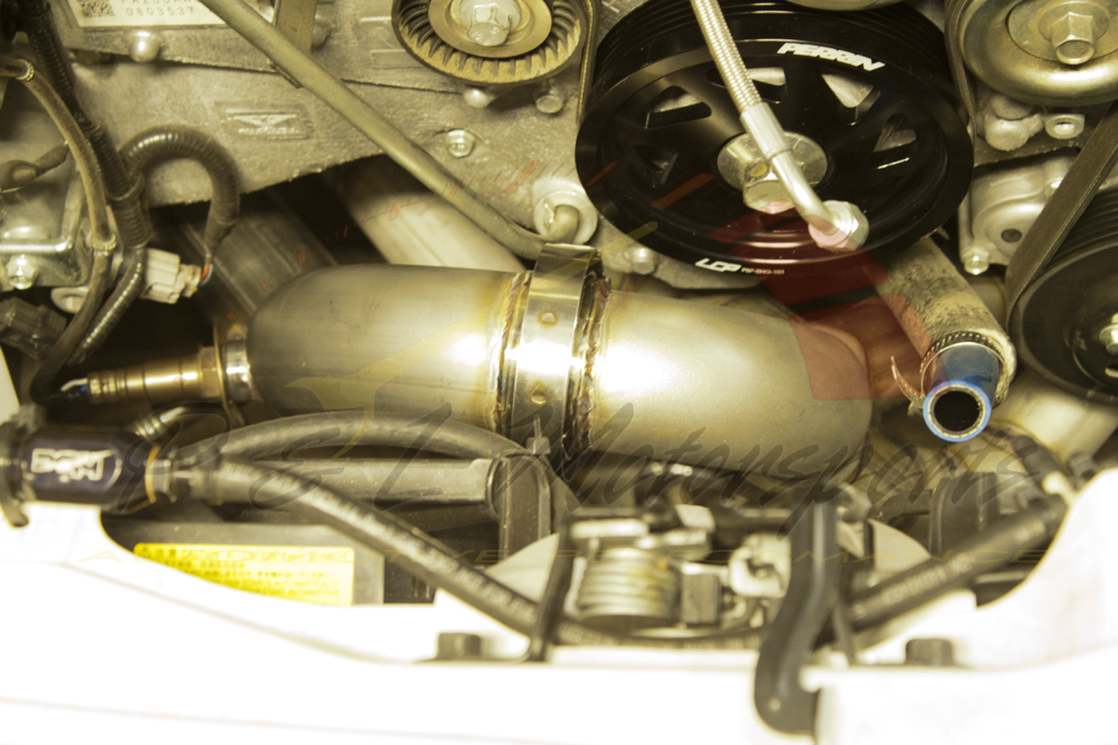

Big doubt about fitment with p&l and fa20club headers : https://s3.amazonaws.com/cdn.pandlmo...er-NA_8635.jpg

It's a bit close to it. I wonder how big the pulley will be!
i cannot comment as to whether it will clear various headers...what i can tell is the dimensions of the over pulley. the drive pulley diameter is 100.5 mm and protrudes 36.5mm from the front face of the factory crank pulley.

i am not familiar with the header.... how close does it come to the crank pulley?....as long as it is not directly in front by a distance closer than 3.8cm, there should be no problem at all.

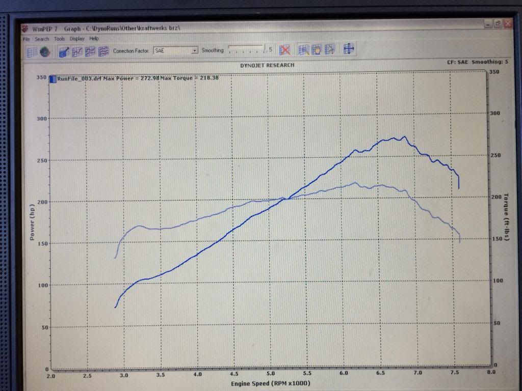

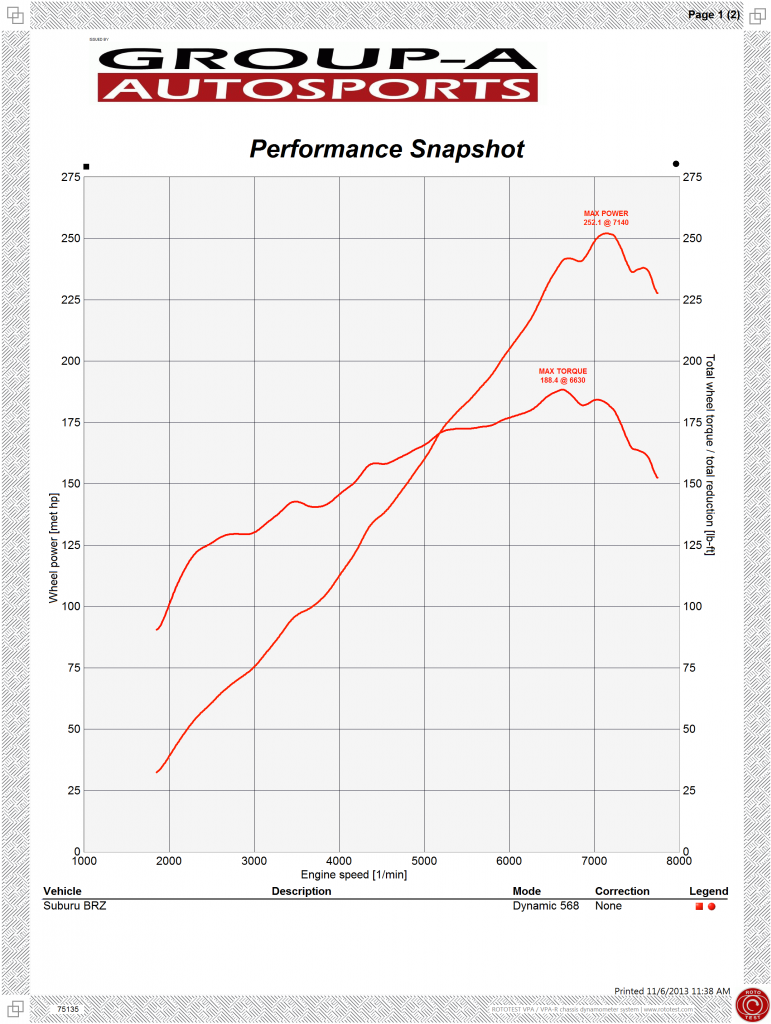

BTW...Just finalized the 91 octane tune with stock header and exhaust
on our in-house rototest dyno the base kit made 251whp
on a third-party dynojet nearby the kit made 272whp and 218wtq
(dyno graphs to follow shortly)

dyno graphs
finalized KW basekit specifications // 91 octane // stock header and exhaust...dynojet dyno
272.9 whp + 218 wtq
91 octane, stock header and exhaust...rototest dyno

Why is the output so rough over 6k RPM? I noticed the smoothing was maxed on the dynojet run(s). Will this be smoothed out as you guys continue to develop the tune further?
How much boost is this at, and what RPM does the supercharger see? Is there overhead for more power? Is the increased redline safe?
The powerband is really meaty from 5500-redline... This should be fun at the track and canyons.

Looks really good. Could you overlay your base line run and boost plot?
