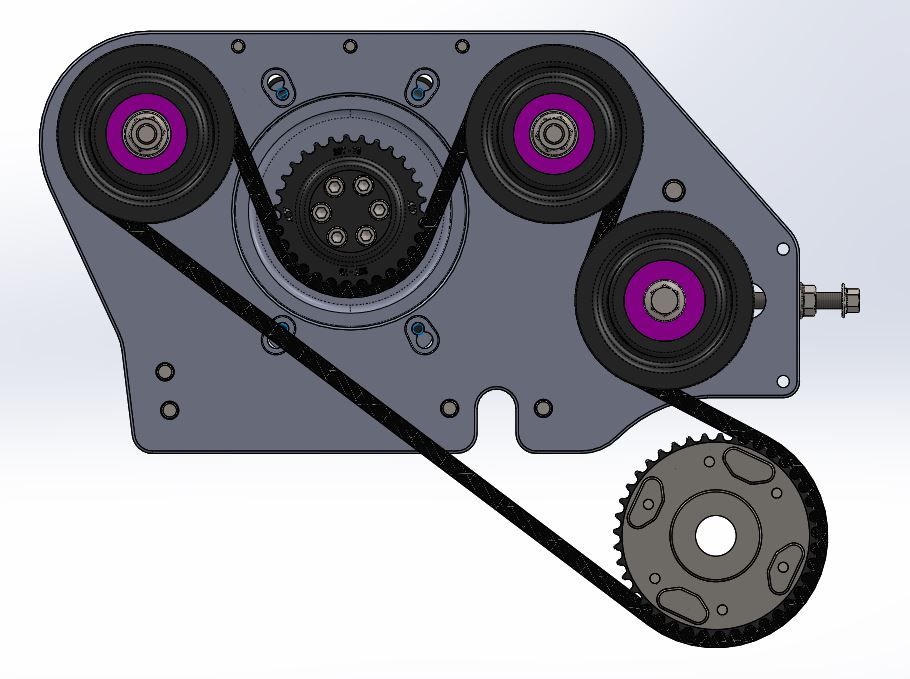

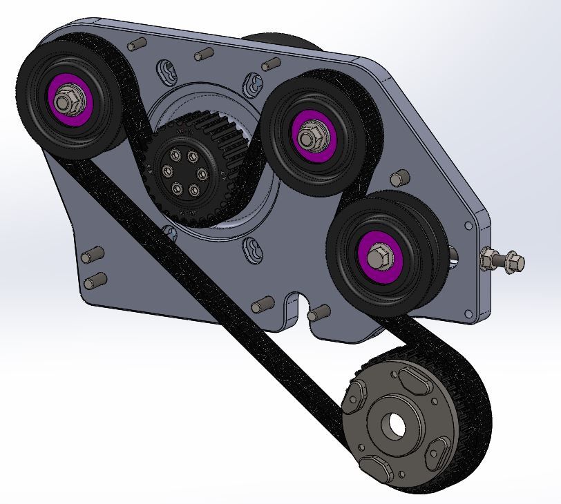

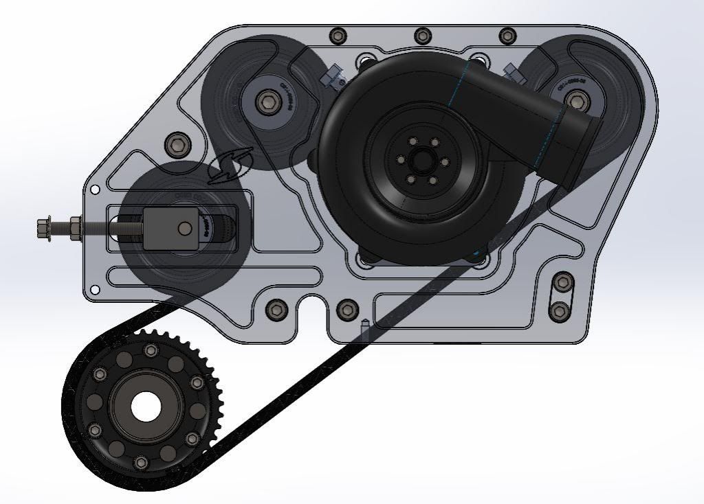

Originally Posted by Calum View Post
I don't know how a cogged belt would react to the cyclical compression of the cogs caused by being under tension while running over a smooth faced pulley. My thought is that the belt wouldn't like it at all, which would either diminish the belts life, or require cogged idler pulleys.
Two pulleys would still satisfy that best practice, would it not? My thought is that there would be two pulleys on either side of the compressor, but lower instead of above the compressor pulley.
I'm not trying to argue here, I'm just trying to expand on my earlier post to ensure I wasn't misunderstood. I posted my idea expecting to be told it wouldn't work, I'm just not sure why it wouldn't work.
1) for the record, according to Gates (the manufacturer of the cogged belt) it is ABSOLUTELY ok to run the belt on smooth idler pulley.
2) before critiquing the layout to heavily, please realize the cad model does not offer much insight as to the placement of the support brackets or parts protruding form the engine. also note....the reason for the double sided belt is because the supercharger is flipped around therefore we need to reverse the rotation by driving it using the outside of the belt...if rotrex had a counterclockwise offering, we could use a single sided belt and simplify the layout further....given these considerations, i think the layout is well thought out, simple, and elegant.
3) i do not understand your proposed layout, can you elaborate some more? a simple sketch for discussion purposes would be nice too

I see the double sided gear belt... how reliable is that design? Would a single sided gear belt design be less prone to deteriorating or less friction/efficient? I'm asking from a learning standpoint.

3) the specs on the Gates double sided belts are plenty durable. should you have any specific belt design questions you should probably direct them to the engineering staff at Gates.

I have zero experience or knowledge about FI belt design hence my curiosity. I'm not sure if telling me to go to Gates is a good answer. KW is using this part as the belt system... would be great to know how many designs KW have used double sided belt system or how many known systems other FI companies are using double sided belt system? It's about reliability.
I forgot that rotrex doesn't offer counter clockwise SC. Thanks fir clearing this up.
Edit, damn phone auto corrected rotrex to vortex.

here you go:
Does the pulley is over crank pulley? I'm concern if it will fit with my P&L headers...
