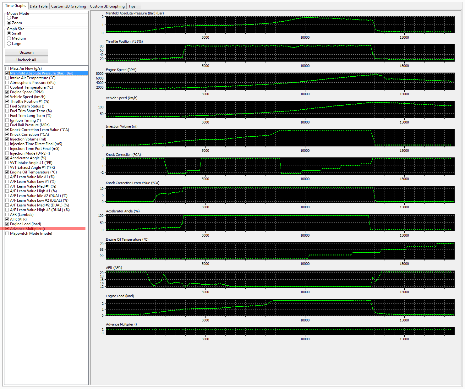

I think his tuner is using the Long Term Knock Correction to add in the extra timing for E85. I have never seen a Knock Correction Learn Value that high. What is the IAM on those runs? Does it ever change? I worry that your AFR is off the scale rich for the entire boost pull as well.
What is the IAM ? Don't see that in the logs. Are you referring to the multiplier? It's 1 the whole time. Afr is 12.17 whole time as well

Ignition Advance Multiplier (IAM). It sounds like your tuner has defeated the knock control strategy if your IAM is always at 1 while seeing knock.
Not sure the "1" i mentioned is right. In ECUtek, logs, where is the IAM reading? I dont see that in my logs? I see something that says "advance multiplier" is that it? I Highlighted it in this image....
It is a parameter that EcuTek added to its logging. I don't remember the exact term for it in EcuTek. I think it is Advance Multiplier or Ignition Multiplier. I believe it gets selected by default, but you might have to click it to have it be logged.
It's advance multiplier, and yes, it's selected by default.
