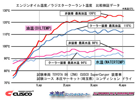

I would be interesting in seeing the results. Cusco also bills this as an oil warmer as well, to bring the oil temp up faster along with the coolant temp.
The graph shows it lowering the peak oil temp from 259 degrees to 239 degrees which whille not an immense amount may be the margin of safety needed. The tests seem to have been done with the Sprintex supercharger installed. Anyone read Japanese?

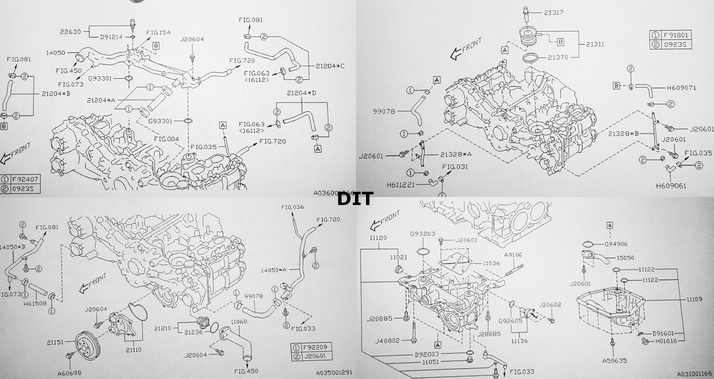

However, I did do some research on the parts diagrams and such for the DIT engine and got the part number for the Oil Cooler:
Part Number 21311AA170 - List Price $180, www.subaruparts.com has it for $143
Thats $100 LESS than the other turbo oil coolers NEW! And it includes the "spill tray" on top!

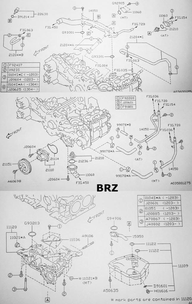

Anyway, some diagrams...
DIT coolant diagrams:
BRZ Coolant Diagrams:
This is what I'm thinking:

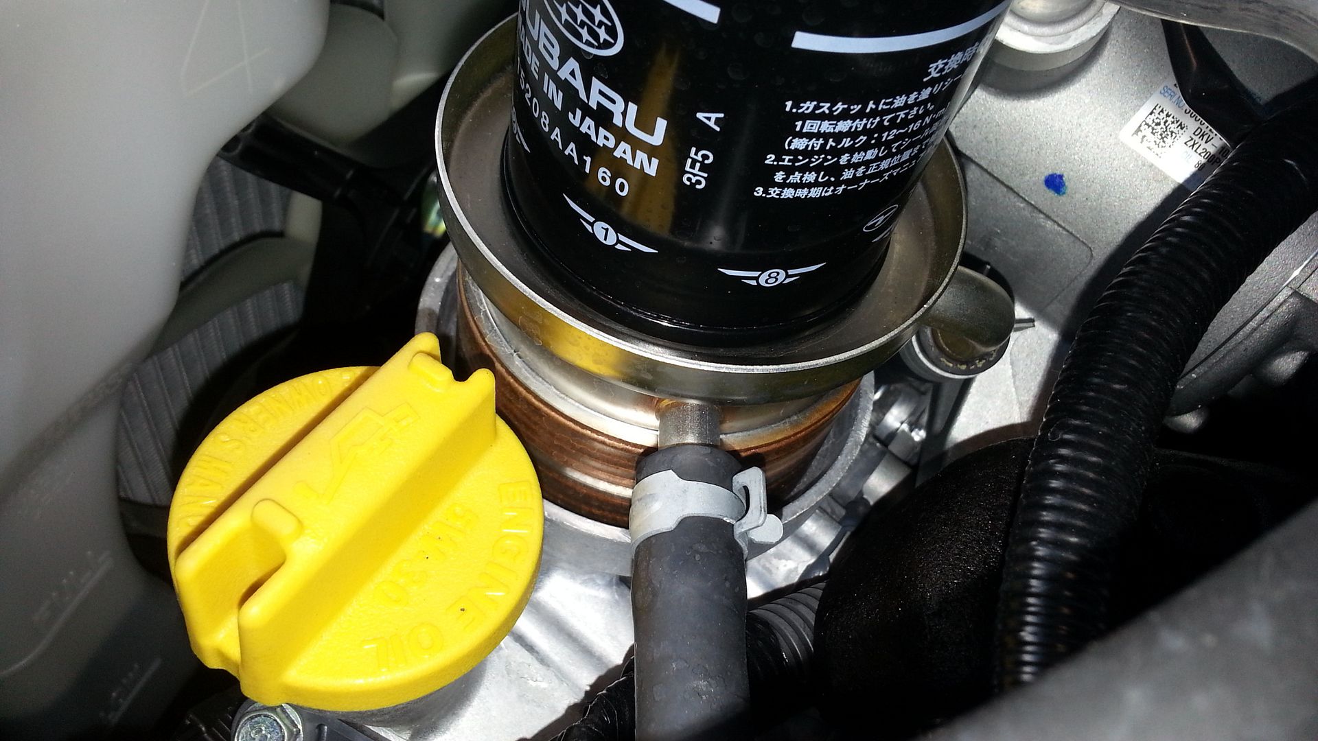

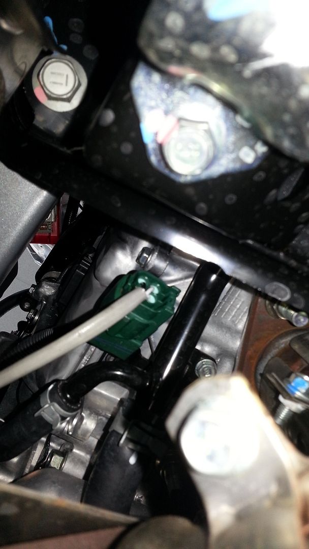

Couple photos showing how the DIT routes the coolant:
Under the engine where the hot side connects back to the heater core piping:
