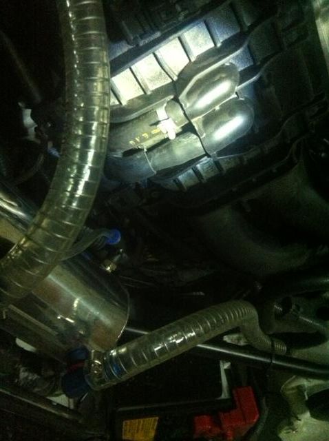

this is the manifold I cant snap shot the one down there I already connect tee T brass goin left for BOV and right For Anther Tee T brass

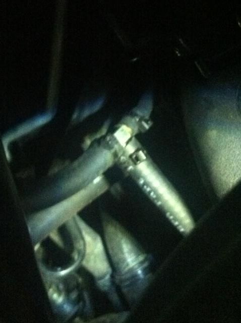

this is the 2st Tee T brass coming from the connectd 1st T brass manifold. the down for Gauge and upper goin to boost controller.
