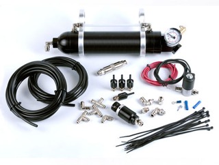

Here's an article about pump-less meth kit.
http://www.alcoholinjectionsystems.c...icle_info.html
"Speed has never killed anyone. Suddenly becoming stationary, that's what gets you." Jeremy Clarkson
Attachment 48613
1400 $... omg. Someone is on crack.
