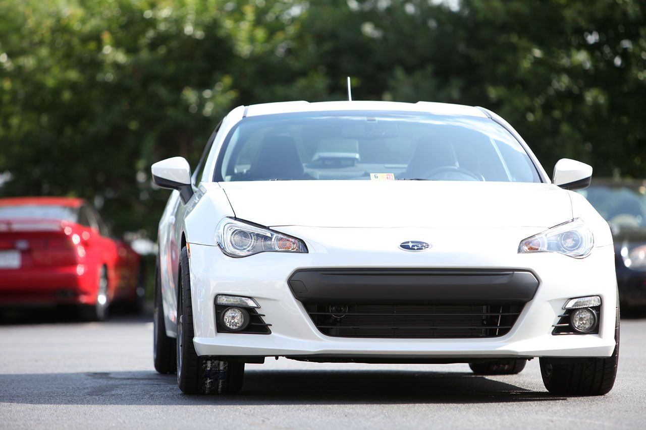

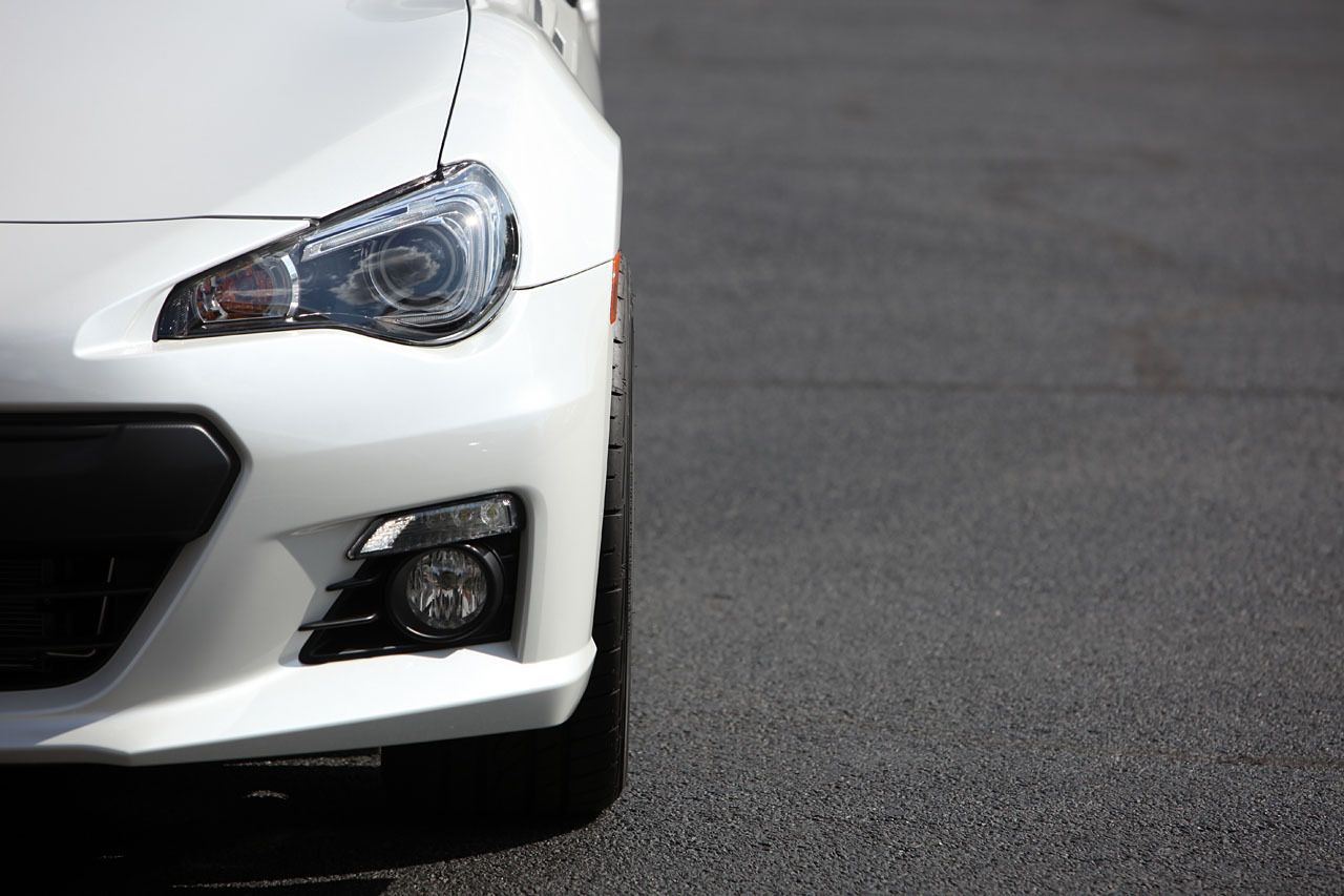

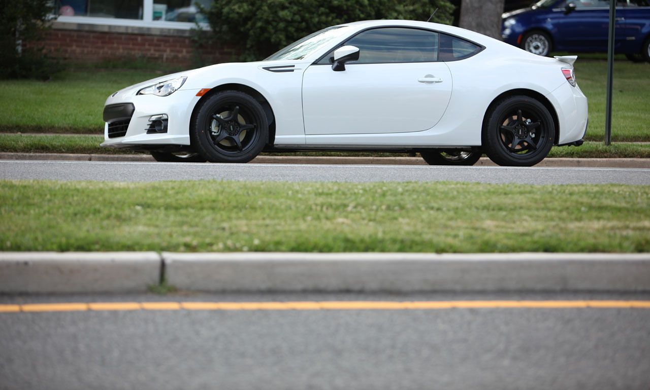

OEM suspension. I have not detected any rubbing. These are 17X9 et +35. Tires are BFGoodrich G-Force Rival 255/40/17.
I have camber bolts in the front and have had as much negative camber dialed in as possible.
[IMG][/IMG]
[IMG][/IMG]
[IMG][/IMG]
[IMG][/IMG]
[IMG][/IMG]
[IMG][/IMG]
