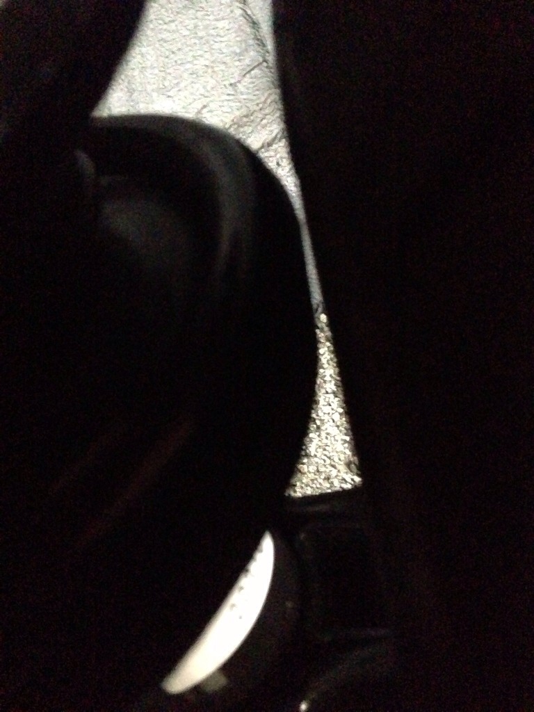

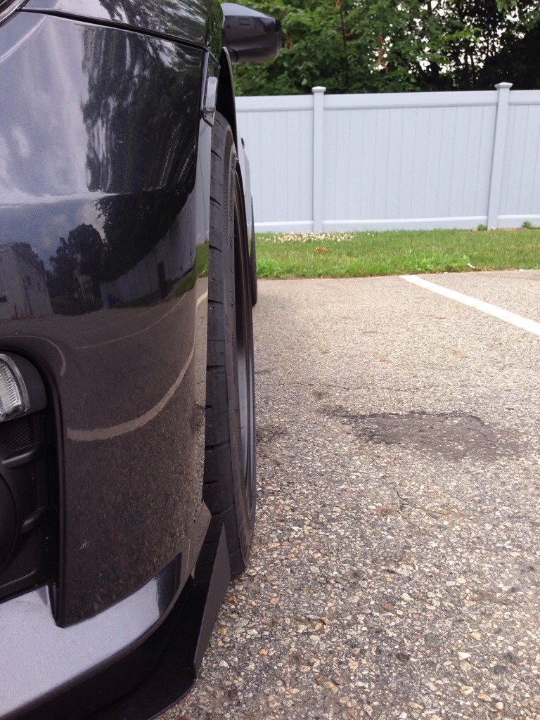

Lee358 08-04-2013 10:32 AM
4 Attachment(s)
17x9 +45 rpf1 with 245/40/17
Attachment 46737Attachment 46738Attachment 46739Attachment 46740
The last picture is the distance between the tire and the coil i have had no rubbing in the last month since install. Wait thats a lie i rubbed once pulling into my very steep driveway thats about it.
hmong337 08-04-2013 12:31 PM
@Lee358
Wow! That's cutting it close. Is there any rub on full lock?
Thanks for posting.
