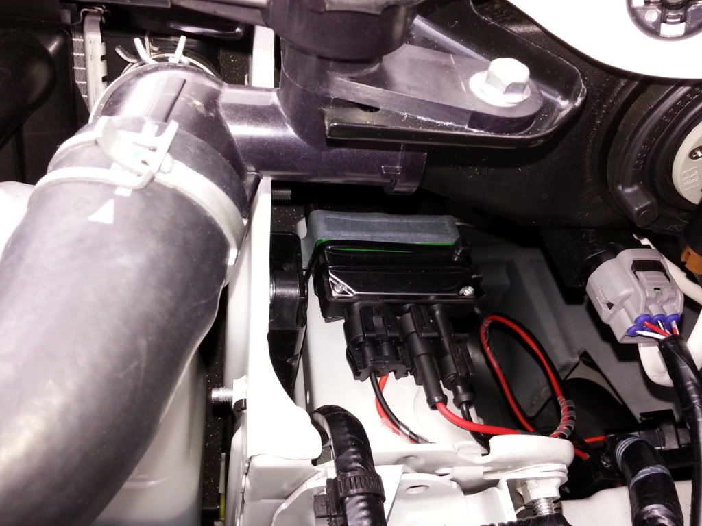

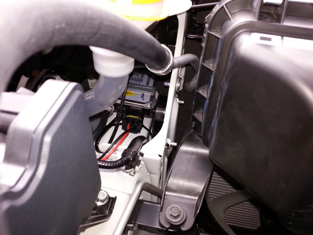

Installed mine under the lights on the frame..
Yeah my other ballast blew now I have 2 different ones also zip tied it down and put a foam under the ballast to absorb vibrations..
On driver side take the windshield funnel out and unclip a harness to have room to work when installing on that side..other side is easy no need to take out stuff just drops in
This look great. How did you find room to work with your hands in there? I couldn't find room to get my hands to do the zip tied !
Thanks.. Do what I did improvise get 2 zip ties connect them together then bend one side like a "U" shape or hook and just loop it under the frame.. The driver side is a bit tricky to get due to the windshield washer container on the bottom.. Just pop out the tube funnel first and the harnesses wire next to it.. Other side is easy
