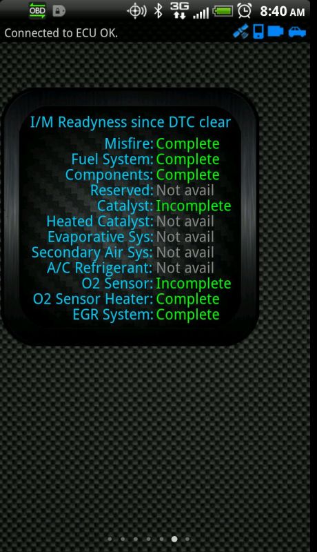

Some states may only do visual, some may just check for CEL codes but if they do "readiness checks" then you will still fail. Readyness test are done constantly by ECU and the inspector will just plug in and interrogate ecu for the data. Failed readiness checks don't light CEL.
you can interrogate ecu yourself with something like the Android Torque app and monitor CELs ,stored cels and readiness check monitors.
When you reset the ecu the readiness check all set to fail I believe then over time they will come good if the ecu sees the correct inputs this can take an hour or so of driving to get all the readiness checks to pass.
not even Ecutek forces readiness check to PASS, it probably due legal reasons not sure.
