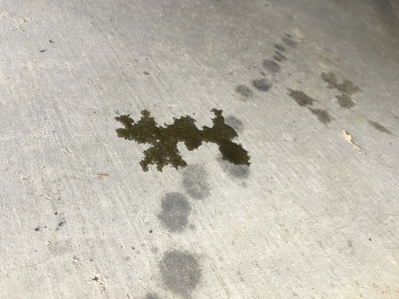

So I had my 2014 brz shipped from an out of state dealer to a local dealer yesterday to buy it. Thing is sweet. Wake up this morning and the thing has pissed all over my driveway... Moral of the story is Use Crush Washers When You Change Oil In A BRZ... good job certified Chevy Mechanic.
The little baby puddle in the picture is from less than an hour of sitting in my garage... The driveway was soaked.

Well, now, that's a shame ........
Who changed the oil .... ??
If it was the local dealer, I'd take it back to them and have then fix it.
If it wasn't a local shop, just get a new crush washer, drain the oil and refill it.
That oil doesn't look all that new to me ...... maybe it's time for a and filter change anyway ........

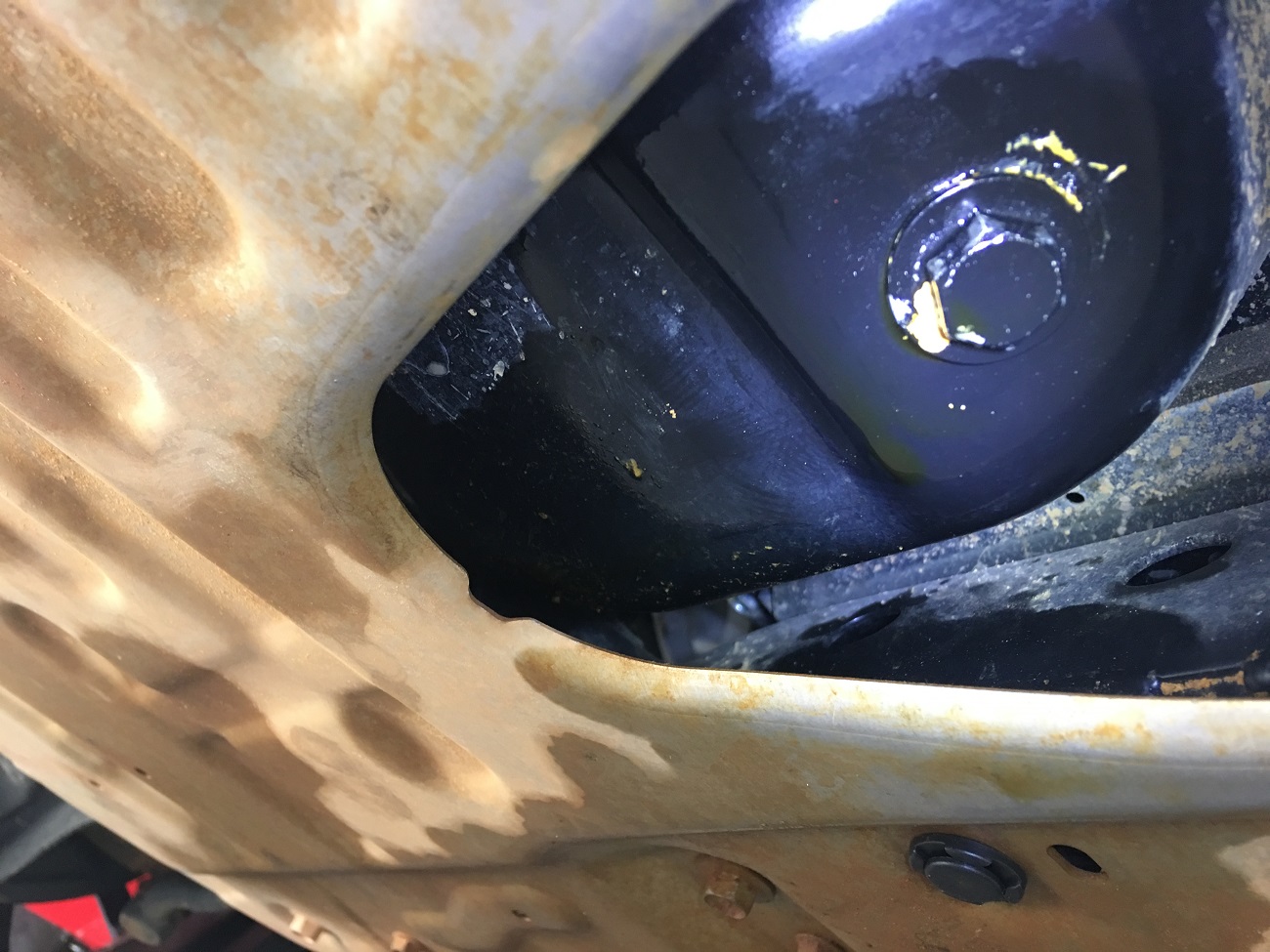

PS - doesn't look to me like it has any kind of washer under on drain plug.

No it was an out of state chevy dealer that did the oil change before i bought it.
Yeah drain plug looked hella flush so my first thought were crush washer. eneded up going to subaru and getting the washer and an oem filter. It didnt have a crush washer when i changed oil.
