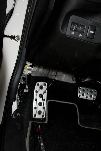

Run the wire underneath the door trim and backseat toward the trunk. There's a bolt right beneath the lower back seat cushion to remove it. Remove the trunk liner and just follow the oem wires.
