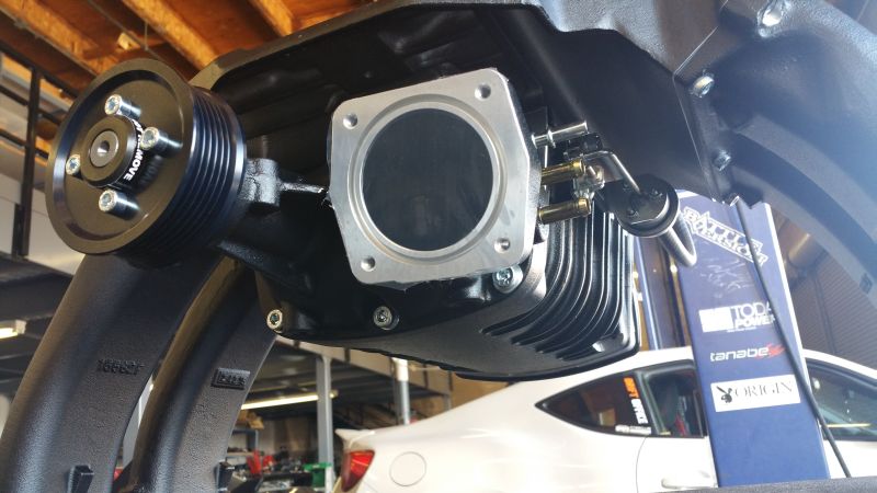

Hey all - just posting up pics where and when I can. Recently had one shipped over to us and this thing is AWESOME and COOL looking as we already know. I'll leave my comments in the tuning segment of the post and I'm sure most are only interested in pics right now so without further ado...
- Bob @ Drift-Office, LLC

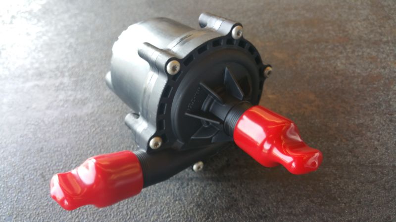

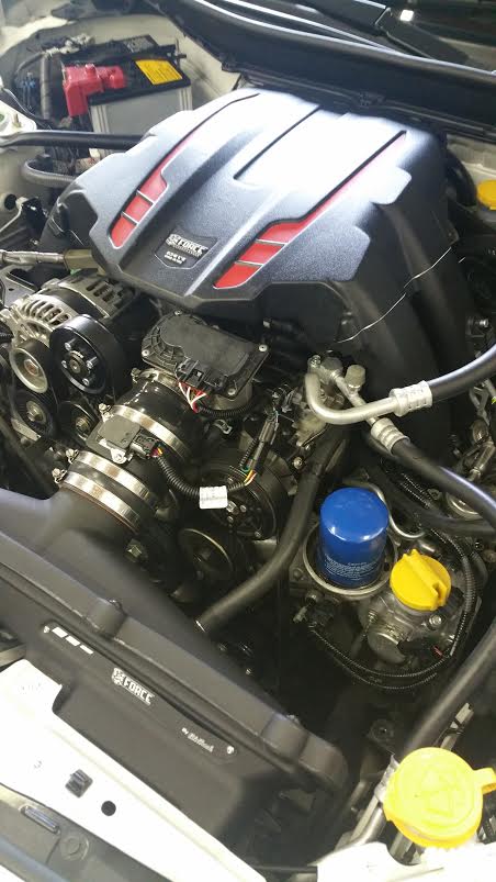

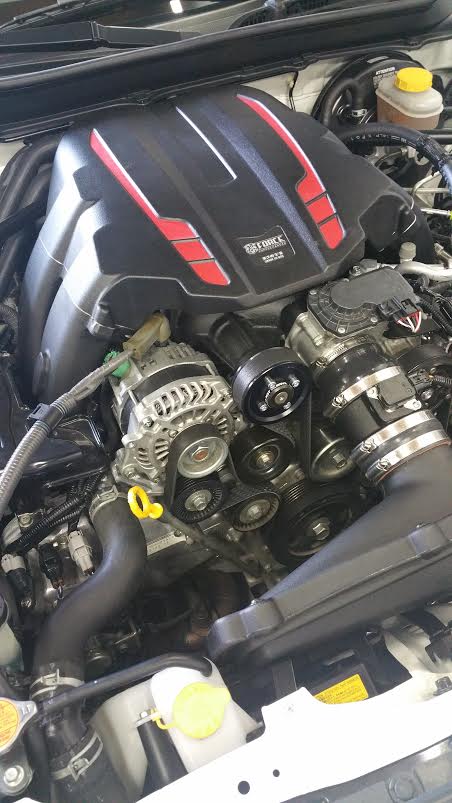

Hardware and Install Notes:
Took roughly 8 hours. We spent more time trying out different hose routing ideas to see which one would end up cleaner. The included binder is through, though I'd have to say that they need a HD version with LARGER pictures for old tired eyes like mine! As a professional installer, when I say this kit installation is a trouble-free experience, I mean it! It's uncharacteristic for kits these days to have ZERO installation issues; all the kits out there have some quirks, but this one really is trouble-free, especially for an early production model (very FIRST batch!)

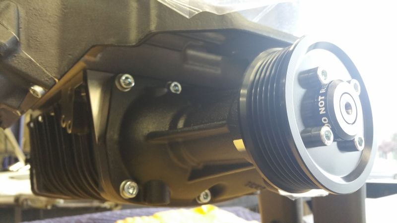

The well packaged shipment came on a pallet - all the components were packed gingerly and as you collect and remove the contents from the various boxes from within, your gaze and hands moves towards the SC unit. Everyone's seen it. Clearly, it's the coolest looking SC kit produced to date with quality that's backed up by a branding that only Edelbrock could. The biggest surprise I hear from peeps during our local revel we had here was that they all thought the construction was that of plastic and that the sand-casting quality was so good that it had them all fooled. Even then, many folks were touching it as if to quell their own disbelief...
You might have heard about it, maybe even seen it on the teaser schematics. There's an actual HEAT EXCHANGER built into the system! Unlike the others with just an air-intercooled offering, Edelbrock had elected to employ an air-water solution that while doesn't eliminate heat (not possible,) defrays and mitigates it as long as possible and gives you much better endurance in a high performance situation than others using conventional / typical intercooler designs.
